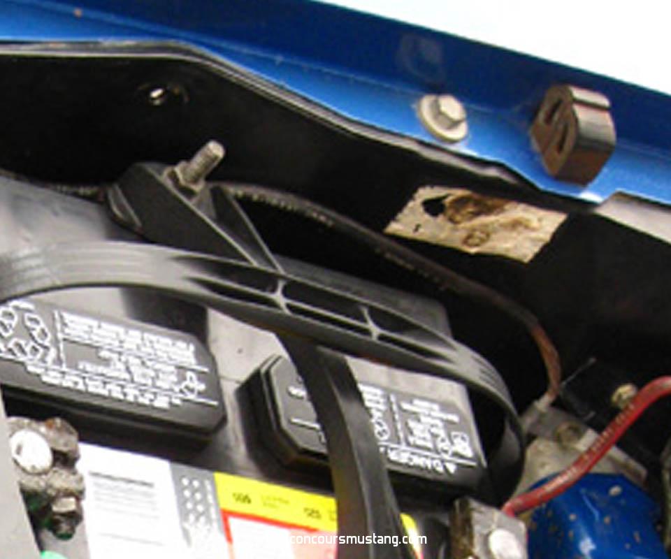

Battery Inspection

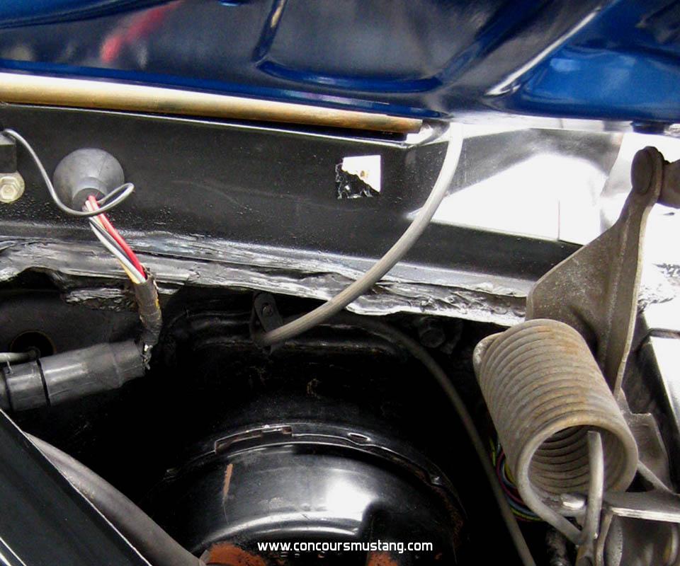

A couple of inspection sticker locations
From other early 70 Dearborn production

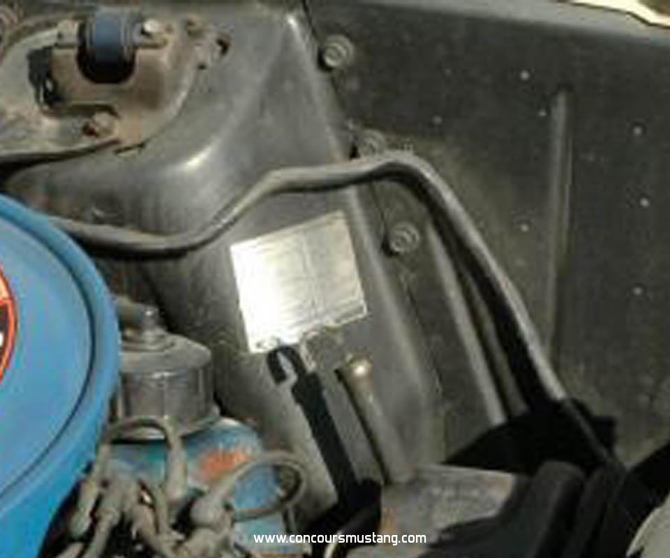

Service Instructions decal

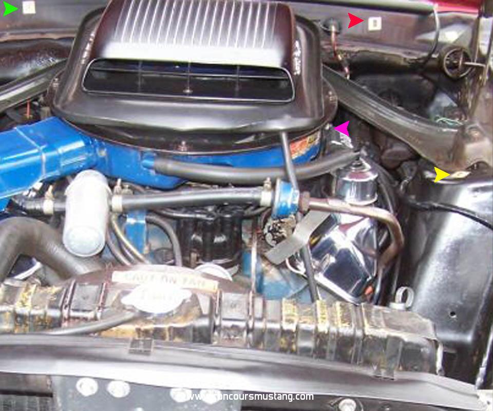

Here is a shot of the overall engine compartment showing the location of the three inspection stickers (green, red & yellow) and the air cleaner element replacement decal (purple arrow)
Here is a closer look at a air cleaner element replacement decal (This example is not the one for a 428 car) but it does show that the decal you want includes the part number of the element rather than a generic decal some vendors sell

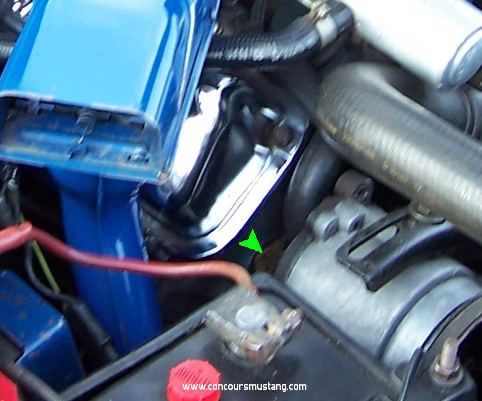

The engine ID label is barely visible on a completely assembled engine and you may choose to redo the ends of the reproduction label you receive to reproduce the original closer. Applied to the face of the passenger side head behind the thermactor pump on this original example . Same location as we normally see/find them on 68 & 69's also

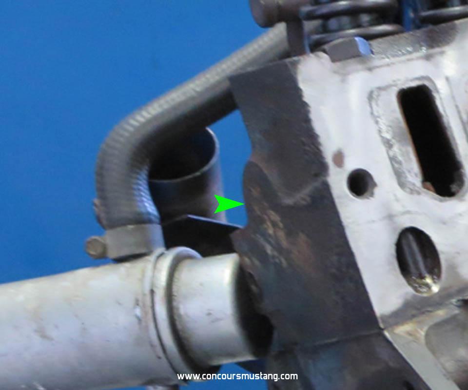

Another example of the same location

I am working on a 11/22/69 built Dearborn car and, based on these photos, it should have the service decal with "Rotunda" in the lower left corner?  Picture is fuzzy but that is what I think I see.
Jeff - can you (or anyone) confirm please?
« Last Edit: June 02, 2016, 11:25:52 PM by J_Speegle »

Looked through what I have and nothing that is that clear - apparently I have not focused my camera on that decal. You do see both versions used during the year (silver bottom rocker and the black bottom rocker)

My early December Dearborn Q code 4sp has this decal, which I of course believe is original.

The silver bottom one looks more modern to me - based on the Autolite font - but there must have been a transition date somewhere in late 1969...??  I have a reference to a Nov. '69 car with the Rotunda black bottom.

My late October Dearborn R code has the same decal as my December car.
