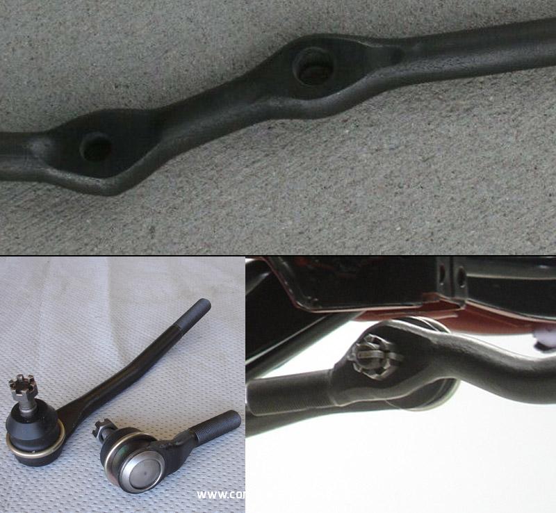

Most of the tie rod associated items were forged so they will be a darker shade of steel (tie rod ends, center link). The tie rod adjusting sleeves and clamps were drawn and machined steel, but should be not as dark, a lighter contrast to the center link. The associated hardware is phosphate and oil but will be dark.

Guess you applied it very heavy. You can lighten up a little by burnishing with steel wool but its not likely to do change the tone allot. Or at least how dark it looks in the pictures. May have to strip and redo the bluing by adding a little at a time with a steel wool pad rather than dipping, soaked rag or by brush.  It may just look dark in the pictures from the lighting or digital settings. Here are a couple of examples that have been posted before from other years and applications.
Finish currently looks very shinny do you have something on it that is producing that look

Think you might have gone too far with the lighting of the finish. Does not look (if what I'm seeing is what your seeing in person) like a heat quenched part any longer. I'm just considering what the process was to make the parts and the results we even see today on similar parts made for our cars as well as well maintained NOS pieces.
We don't look for allot of the 6 cylinder paint marks since restoring them is not as popular and people often don't buy and take care of them like V8 cars. I've got 65's with roundish with runs paint identification marks from unrestored V8 center links and by 66 (on V8s but still C5ZZ part numbers) the identification marks moved to the knuckle that attached to the pittman arm
Not sure what the green stripe is but would not suggest using a service part as your guide for the paint marks since it may have been made 5, 10 or years later than that by a different supplier possibly

I think, for future projects, you need to forget the pads and the machines your using to start with. You buffing away the texture  it appears which is not helping
As far as tone if the true color your seeing is closer to the indoor pictures I would stop and call it good and think about how your going to reach a similar finish to the other steering parts you will be refinishing. When the center link and the other parts will be viewed they will be in the shade and under the car so that is likely the conditions we need to view them in and compare the "look" IMHO
