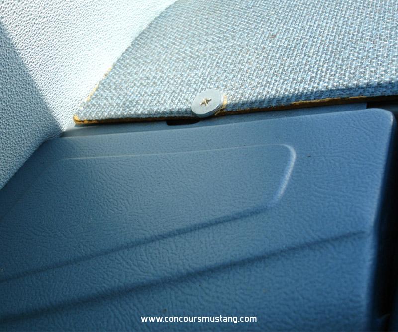

Not sure why a spacer was needed in that location but its very easy to see that it and the rivets are not factory. Since that lip rests on the metal structure of the package tray I would just return it to factory. Sort of the focus here :)
There should be no pressure at the outside (towards the C pillar and head liner) area from the passenger with the quarter panel installed and screwed/bolted down in place. There would not be,  originally, a screw holding down the package tray cover as shown in your picture. Now if the quarter trim with the spacer installed was not attached to the package try then yes its likely it would move outward from a passenger pressing against it.
Bottom line IMHO remove the spacer and resecure everything like factory did

Great, informative picture. It confirms what I saw at disassembly and what makes sense. I had no screws in my car's tray, although you can tell the quarter cover was installed with screws in place, as it is wallowed out a bit. The original 'spacer' or standoff was masonite; I duplicated in lexan cause the originals were broken. I can see why they are there, to keep the cover panel from compressing in. The spacers bear upon the subframe of the c pillar.
The spacers have to penetrate the headliner, or either the headliner is worked around them. I just need to understand how to do that without mucking up the headliner install. I don't know if the 1/4 panel covers were installed before or after the headliner, I ordered an interior assembly manual - maybe it will explain. The Graham assembly manual, which I have, doesn't address the detail;actually only addresses deluxe interior fitment. At any rate, the headliner is in and the covers are not...
I like the idea of abandoning the standoff and just locking down the top of the panel with the screw. I am going to pursue that idea. Very very good thank you.!
K
ps looked again at the picture, that is some awesome work. I hope I can do half as good
That is just factory work. Picture is from a car featured in the Unrestored picture section of the site.
