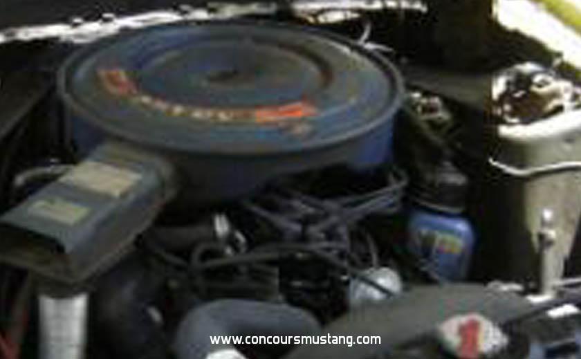

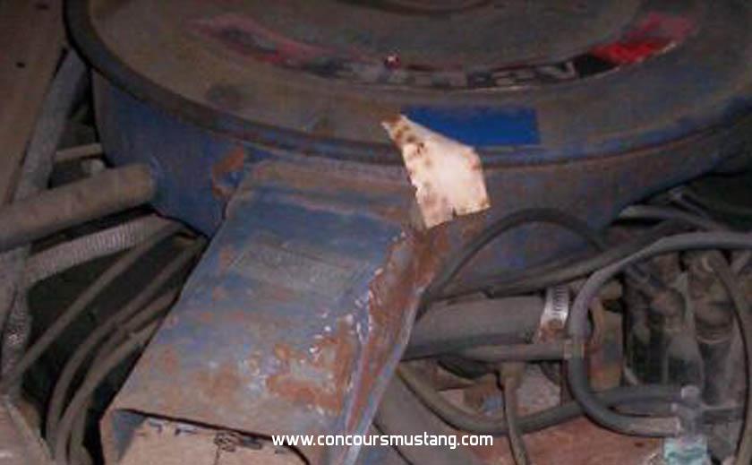

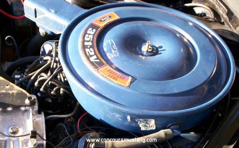

Re: 1970 351 air cleaner decal color - Early Dearborn Engine Decal placement
« Reply #3 on: December 03, 2014, 12:47:05 AM »
Do you know if the decal in your image above is original and correct for my car?  ..........
That appears to be and was reported to have been an unrestored car from the same plant and period as your car. Another angle/shot of the same. With what remains of the other decals sure looks original to me
A couple of examples a month before and a month after - same plant
