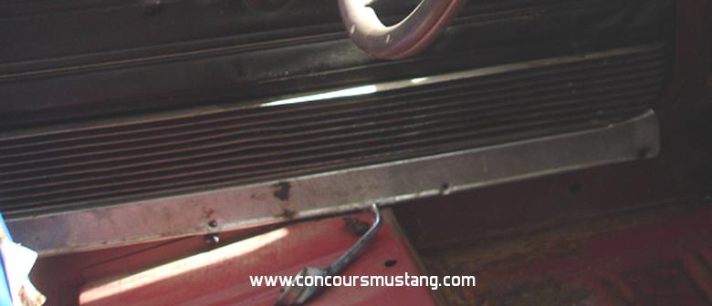

The grill looks (its the same) as the deluxe interior lower door grill. Not sure what a part number will help with at this point ;) not like you can order or and I think a service replacement one going to be a lonnnnnng shot.  Originals and reproductions are available
Picture of lower door grill being used on a standard interior car with factory 8 track

Ran that number and it's not a Mustang application for a factory 8 track car. The picture I posted above is what I've seen multiple times on standard interior 67's with factory 8 track.
As for the holes I've got a number of examples were it appears that they used the same size hole saws/drills at all four corners
This subject has been posted here before - one from the same plant and looks like the same worker made the holes
http://www.concoursmustang.com/forum/index.php?topic=7888.msg45196#msg45196
Close-up of the cut-out hole from that example (7F03S134867)
Also have San Jose examples (below 7R01C159880) that look almost exactly the same
At this time its apparent, at this time for me, that the doors did not come pre-stamped (cut-out) for this option, leaving it up to the line to make the cut.
