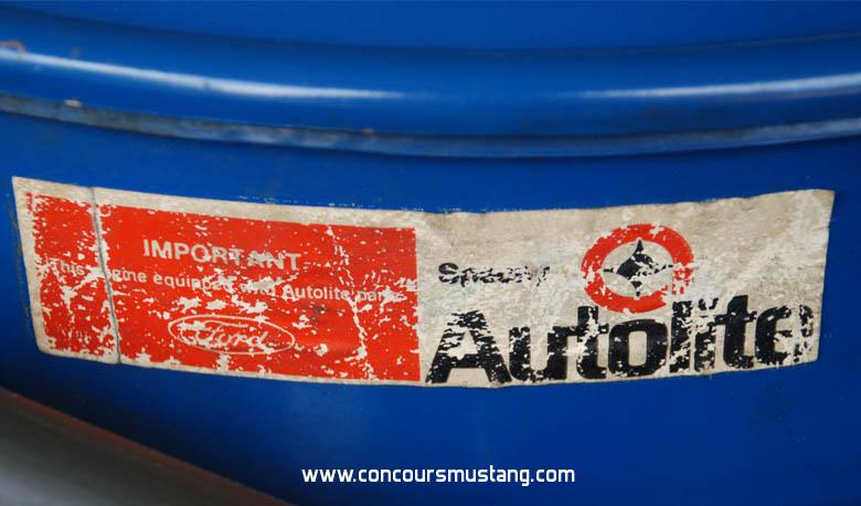

MAC's Auto Parts has reproductions of this style of Autolite decal. (see below) Dennis Carpenter carries them as well. Would this be correct for a February 68 SJ S code air cleaner?

............... Would this be correct for a February 68 SJ S code air cleaner?
IMHO looks good pretty good. Sure its still a vinyl sticker but likely the best choice for an off the shelf item currently

If you try that you'll have to figure out how to apply a very thin sheet of clear over the time to be "correct"
But if I was going through that effort I would have to fix the "star" - make the correct fonts and take care of the other short comings with the decal design. :(
Base on a comparison with originals I have scans of. Another 20-30 hours I would guess might make things right.
Close enough reproductions are just what they are.  ::)

Not that I'm going to go through all that effort, but could you post some scans for reference?
See the differences? They did a nice job but fell a little short IMHO

Jeff, thanks for posting the pic. It's always great to see examples of the real thing. Many of us don't have the opportunity to study such details in person. Especially up here in the rust belt, where the old cars really took a beating. "Survivor" here means it still moves under its own power.  :o
The differences are subtle, but still there if you're looking for them. I think the repro is a pretty good effort, for  3 dollar decal that isn't going to sell in huge quantities. Presents an opportunity for someone to create concours-quality reproductions, with accurate materials, but at a higher price. Would someone restoring a top-dollar Shelby pay $30 for a more accurate decal? Seems possible. I'm satisfied with this repro - for now  ;)
Believe that is where this example came from. Out in rust free (well most of the time) we didn't put the cars away like you guys and sometimes just use took it toll on conditions
