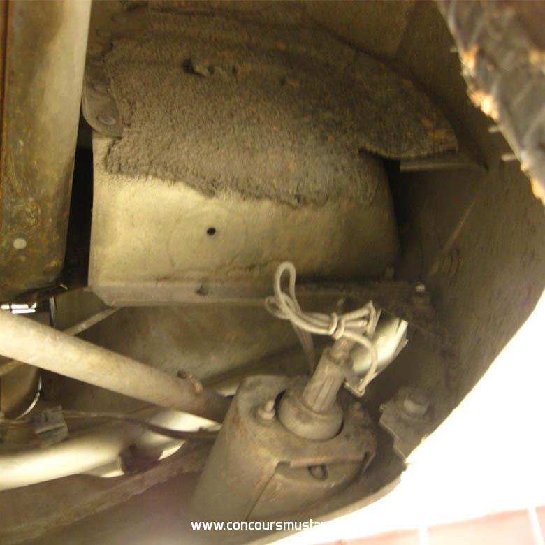

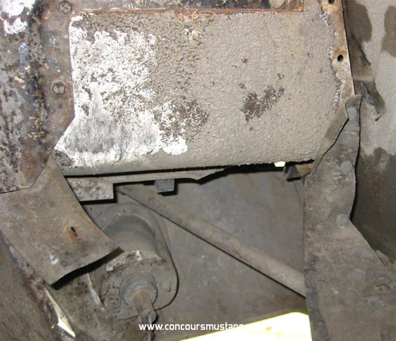

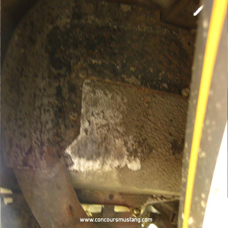

They were fully primed with red oxide prior to their arrival at the plant. Back side
2. Were the head light buckets installed before or after fender installation?
Not sure if it makes a difference for the final look of things. Back side of those will normally have some light gray primer (no red) with logical body color overspray. Not unusual for then to receive a coat of light gray primer (as a surface primer) on all exterior colors like the main body of the car (unibody)
Back side should have either a light coating of exterior color following a logical pattern (directly behind wheel lip, back edge and front edge as the painter made sure of a nice coat where it was important. In some cases there was a pretty nice coat of exterior color on the back side depending on the worker/painter. Remember that the guns were pumping out ALLOT more overspray than today's spray guns so you'll need to compensate for this during the application. The possibility of sound deadener over the back surface is another detail (if it was done) applied later in the process.
  If after fender installation, were they installed before or after the application of sound deadner?
Sound deadener was pretty much the last step before the wheel and tire were installed.  So everything was in place and (depending on worker) all surfaces could possibly get some sputters and splatter if not direct application - bumper arms, back side of front lower valance ......

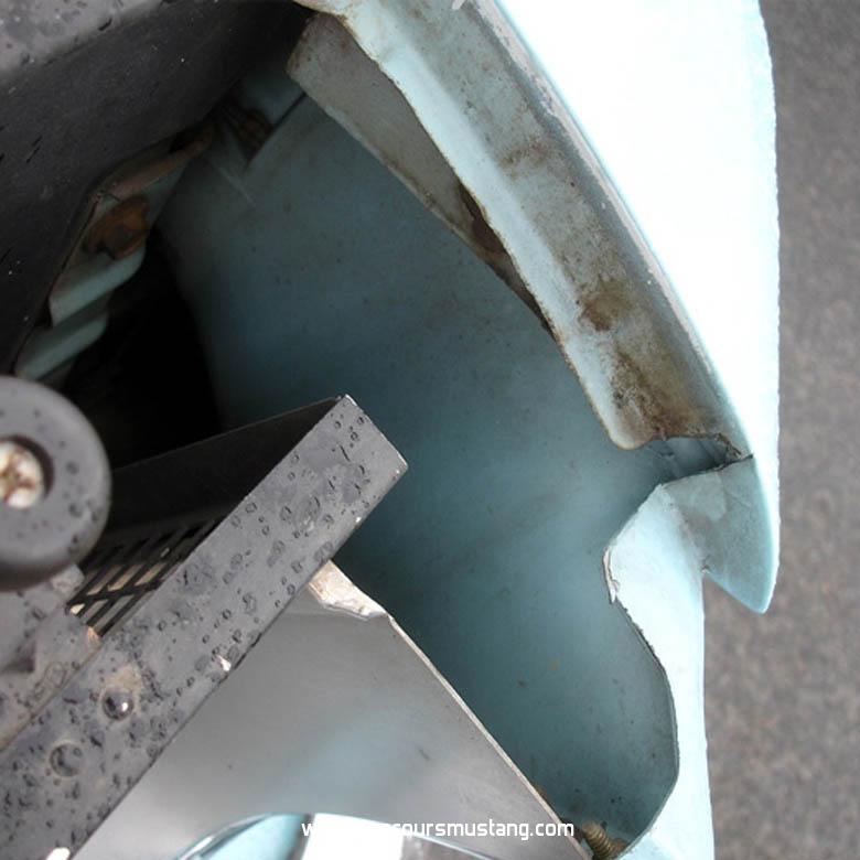

Jeff, the grey surface primer that could be found on the head light bucket....based on your observations, did the line painter make an effort to paint the back side or was it simply coated as part of painting the exterior surfaces?
Don't believe there was an attempt to paint the back side of the headlight bucket other than attempt to cover at least with a coat of the section that faced the grill opening when the hood was open. Just like the back side of the fender that would show through to the interior and the driver/passenger when the door was open. Think this is the same thought pattern by the workers, inspectors and engineers applied here
Here is an example of the surface I'm referring to
Of course as mentioned the paint flowed allot as did the overspray so when painting the edge (for example) of where the fender would be attached the paint is directed at a 1/4" + wide surface while 95% of the paint traveled to surfaces directly behind - the back side of the headlight surface with about 50% of the paint spray
