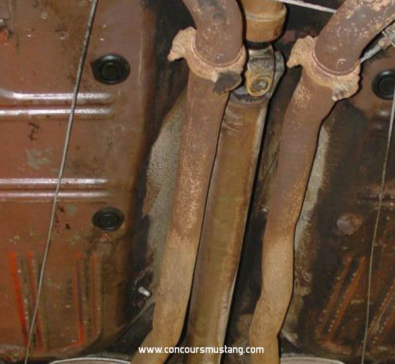

To help the discussion here are a few 69 Dearborn Cougar examples where they were only coated in the tunnel. It appears that (though it could happen of the worker got off target) they didn't plan on doing the floors on these examples/model of Cougar

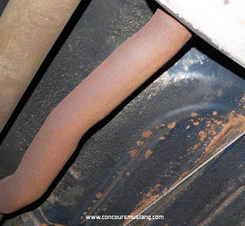

Nice picture showing the angle the exhaust clamps were installed from. Worker just stood in the one spot while tightening

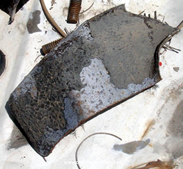

Sample to show the thickness and close up of the texture of this one example
