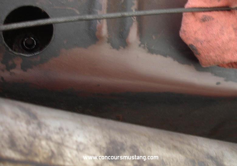

As for undercarriage nothing IMHO is going to be right - right out of the can. Remember that the tint on the coating from the firewall forward was often different to see when compared to the finish from the firewall rearward.
Best to examine your original floor pans and frame rails for original examples - best source. Without that your guessing and looking at what other cars from June/San Jose have
Examples I have of that period and plant are very similar to mid to late 66 - a muddy red look

I mix in some black to the base red until I get a color match to an original area cleaned off. Usually over the transmission or rear axle in a spot protected by grease.

As John mentioned you can use a small amount of exterior color or tint to get you to an acceptable tint. I used a combination of about 6 colors but mostly some white and black
