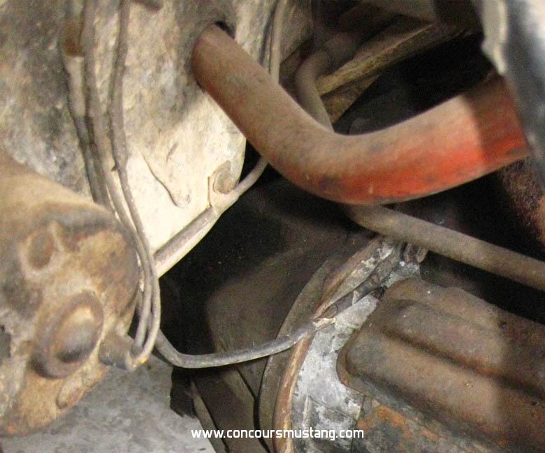

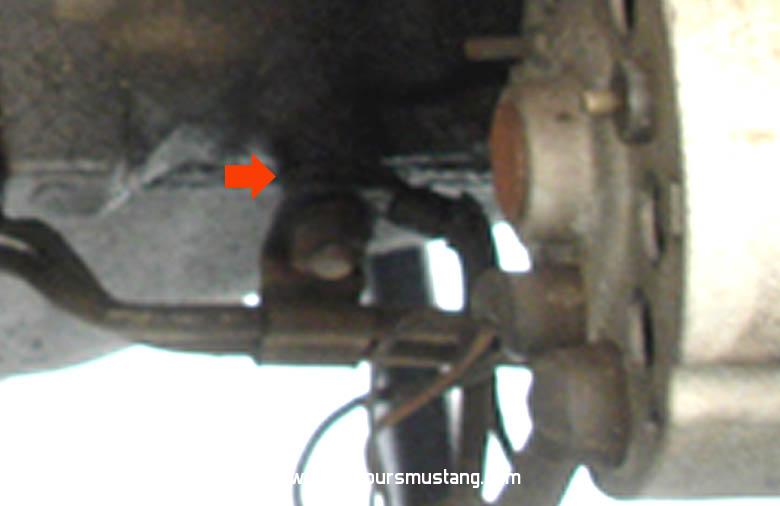

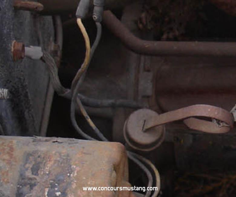

Re: 1966 6 Cyl Ground Cable Mounting Location
« Reply #3 on: November 02, 2015, 04:10:44 PM »
Are you asking about the battery ground cable?
Good idea
Here's a picture - finished out all the possible ground cables and makes the thread a bit more complete
