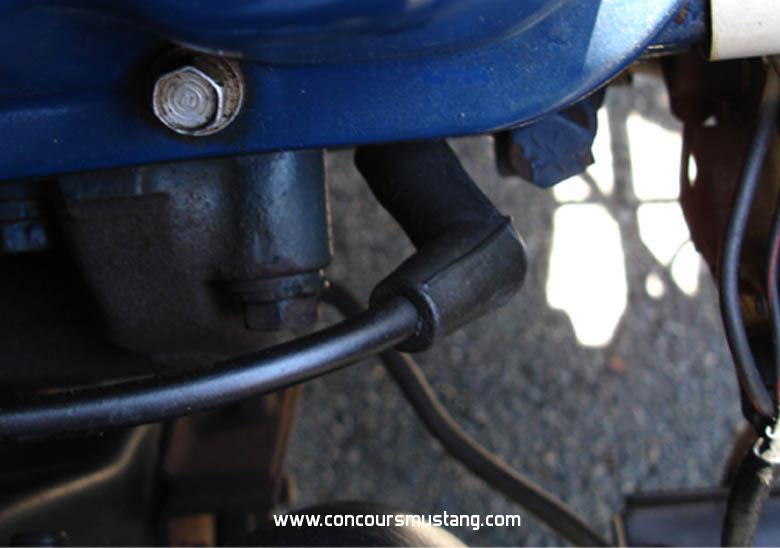

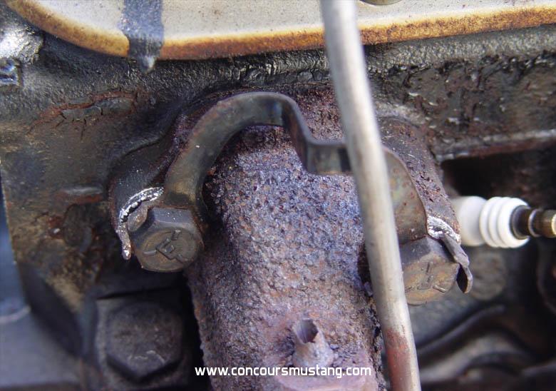

A couple of pictures to help others with the feature being discussed
Have you researched to see if those style of locks were original on your car given the Dec 65 projected build date? Have Jan 66 cars with the washer style (first pictures I pulled up) If the car in your signature is the one your discussing in this thread
Of course its more important to compare when the engine was assembled but we don't always have that info
The 65 style
The new and improved style
