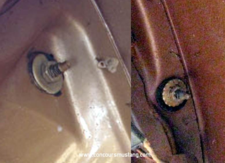

July 67 Metuchen coupe...are there flat washers between the sealer-nut and tail light panel?  Car I am working on has been apart many times - 5 of the 6 had both a nut and flat washer.  The sixth nut was not standard.

Sorry can't tell you which style of washer was used for your plant and time period. Best compare the others you have.
Didn't have any NJ specific pictures of this area. These two styles were used at other plants

My nuts.....or more correctly, the nut/washer that are securing the quarter extensions to the vehicle are like the nut/washer pictured on the right in Jeff's post.  However, behind this nut/washer I found a slightly smaller flat washer that fits over the formed hole in the tail light panel.

 There is no callout for a separate washer. There is supposed to be a sealer material as part of the nut/washer assembly (373556-S100) and the sealer "may" have pulled thru the mounting hole in the body if the hole was off center or too large. As an assembly line fix, a washer was used - note "may". As this was the trunk area, there were standards (Ford or federal ?) to not allow exhaust gasses to enter (leak into) the trunk and the interior in general and this "may" have fixed that leak. I looked at the 64-66 manuals and they have a steel washer and sealer washer called out. On the other hand, previous owner may have not had the correct hardware.
