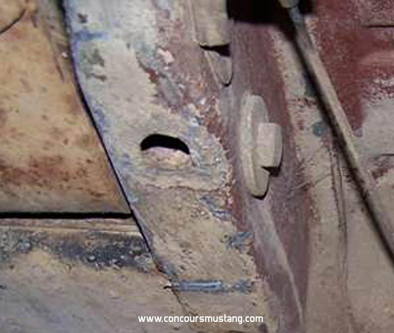

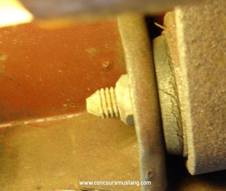

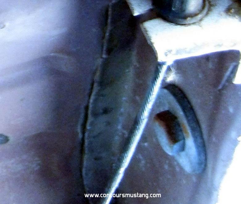

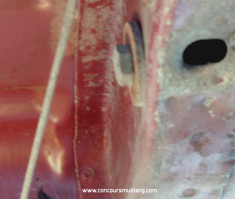

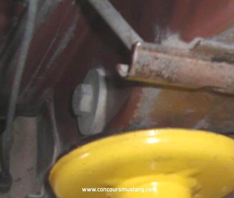

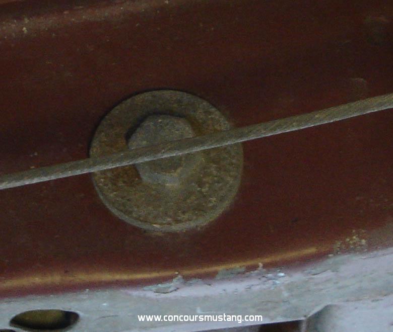

Some pictures of some relatively nice originals on cars
