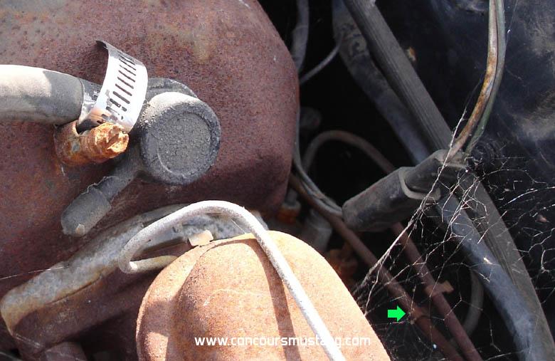

I have this clip left over from my underside restoration and I have no idea where it goes.
Car is 67 fastback 390 with c6.

Looks like a brake line clip  - clips one front brake line to the other - likely in an effort to reduce rattling. It is shaped differently that others I've seen - What plant?
If I recall correctly typically two are used
« Last Edit: March 12, 2016, 06:09:53 PM by J_Speegle »

Its a San Jose car.

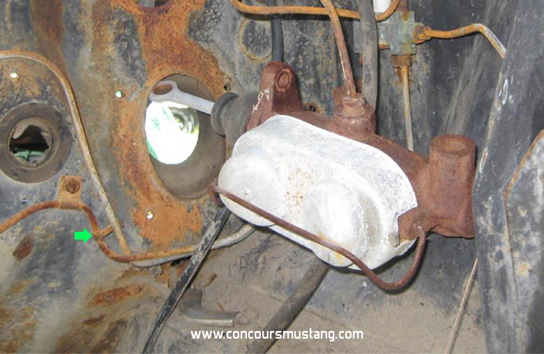

Guess I just remembered then shallower
These pictures will provide where the two were typically located. Can't be certain that all cars got both but I believe Power Brake did
