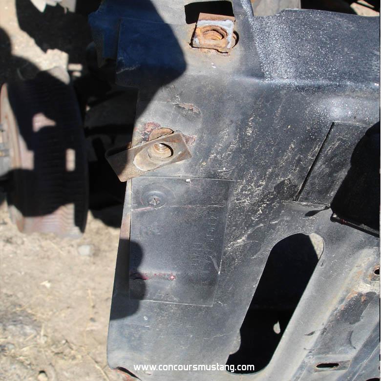

I have read two separate posts on 69 Dearborn buck tags. This post indicates the tag is mounted on the inner fender top, near the hood hinge and another post indicates the rad support behind the fender. Which is correct for a Jan built car?
65 Caspian Blue Fastback C Code, 11/4/64 SJ Build
70 Boss 302 9/29/69 Dearborn Build
12 Black GT500 SVT Convertible
Re: Buck Tag - 69 Dearborn
« Reply #19 on: May 27, 2016, 04:29:45 PM »

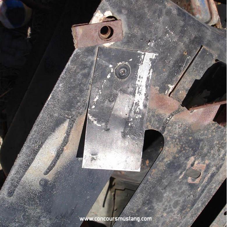

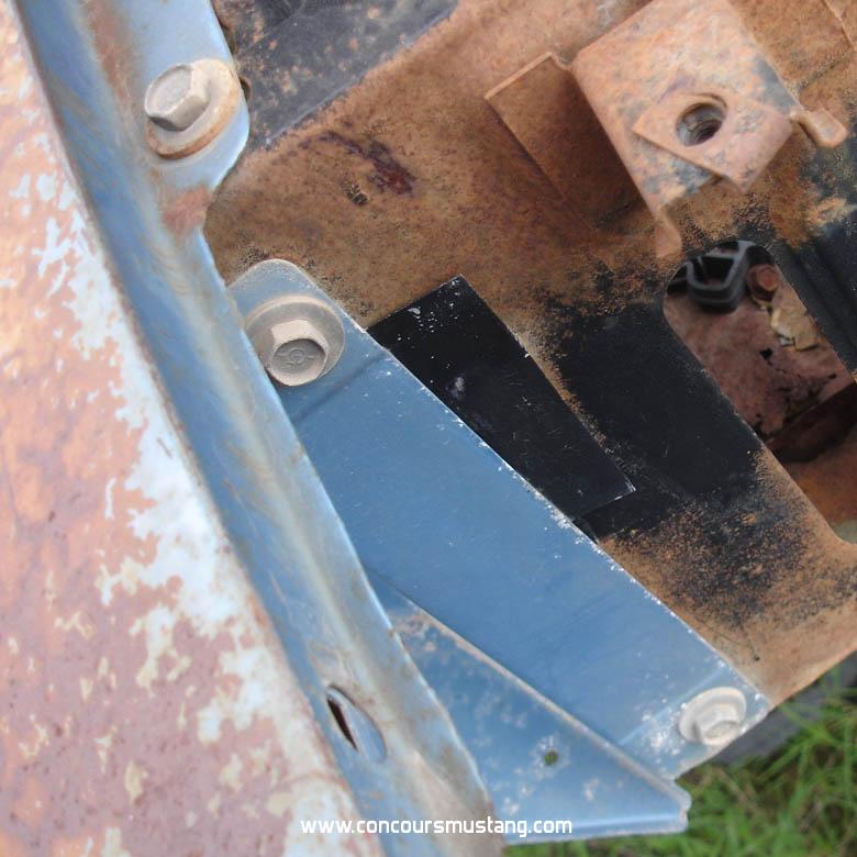

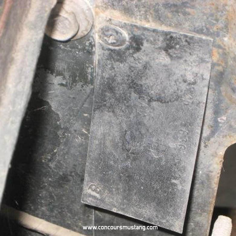

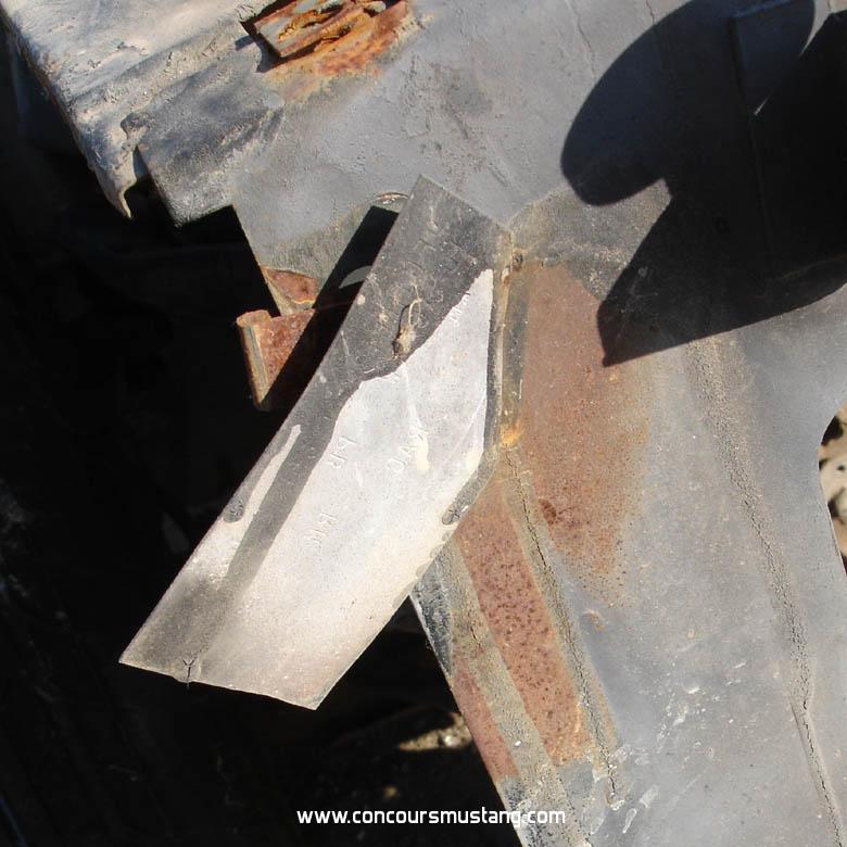

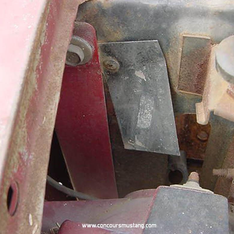

The tread got off topic again and some NJ picture and info crept in I believe. Only see two mounting pictures in this tread one from the Dearborn car in the original post (to the radiator support) and one post showing a NJ location.
Standard expected location IMHO (where I've always found them on 69 Dearborn cars) is the passenger side radiator support near where the upper fender mounting bolt is attached. Not unusual for the buck tag to be under the fender since it was installed later
Examples through the production year. Pretty consistent
And a shot proving that they were in place when the engine compartment (and car)  was painted semi-gloss black
