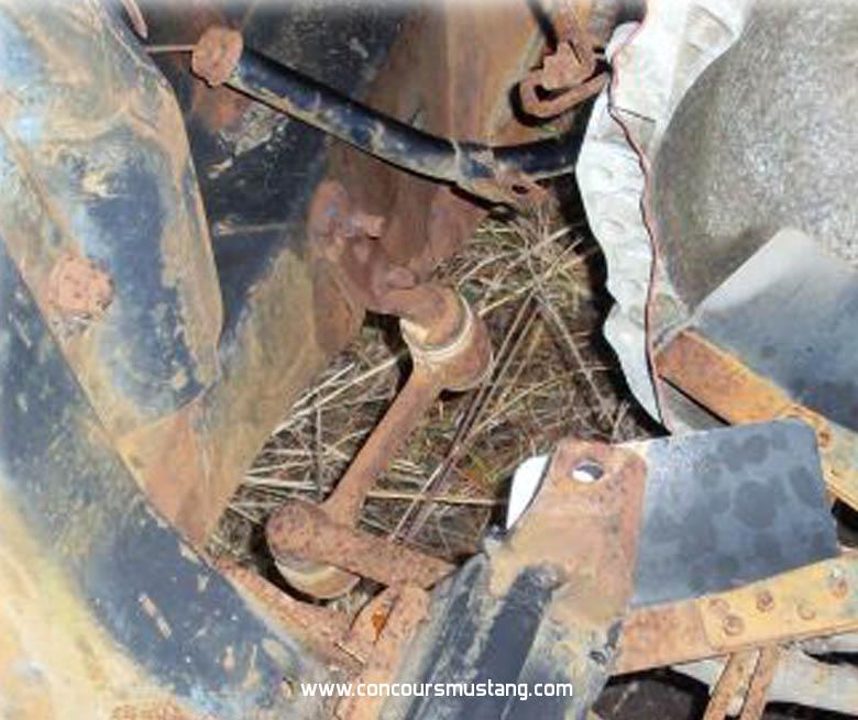

Hi ,
I saw 2 types of idler arms. One is built in one piece and bolt to the frame rail and the other one have a bracket like the black one in the picture ! What is the difference between this 2 ? The one piece its good for a p/s car ?
Mustang Fastback 1968

« Reply #1 on: July 13, 2016, 06:03:16 PM »
The bottom one is the correct style of the two. Other style is a aftermarket design often seen
Right this moment I can't recall if castle or jam nut is correct for the idler bracket nut in 68 but sure others will chime in :)

« Reply #2 on: July 13, 2016, 11:33:42 PM »
The idler arm is the weakest link in the steering. They are typically the most common item replaced. The nut on the bottom is a cone shaped lock nut . It is larger but similar to the style used on the rear end center section.

« Reply #3 on: July 13, 2016, 11:40:17 PM »
They can be rebuilt but it is a pain. The original assemblyline style is hard to find now. I try to keep a few rebuilt ones around .  Chockostang ? Sells a very moderately priced respectable replacement alternative that although not concours correct is better looking then any other replacement I have seen . I would not think twice about using it on a driver car for a original look.
