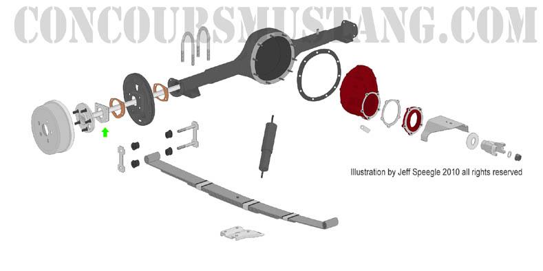

What is the finish for the black on the rear end housing SGB ? The rear hubs are cast iron ? And for the retainer plate ?
Pictures of each/most are shown in other threads as well as articles and threads showing or offering tips as to how to reproduce the original look

Hey Jeff, what is the finish for the black on the rear end housing SGB ? The rear hubs are cast iron ? And for the retainer plate ?
Sorry for the delay - its show month so many of us will be traveling this month and away from the internet
Rear housing is a SGB with a natural unpainted surface were the third member attaches
Rear brake drums are cast steel  - normally darker IMHO that what one would see with just bare cast iron - cast black paint as a result of heat treating of some form
With machined surfaces surfaces highlighted and weights natural untreated steel
Pictures are not offer to illustrate anything other than contrast between the different metals and surface details possible on your particular style of brake drum
Not sure what your referring to as a "retainer" plate. Could you help out here so I can help you out. :)

Thanks again Jeff, i talk about the bearing retainer plate in the picture here !

Here Jeff, took a picture today to help what i mean ! The hubs and the plate , need the original color ! Thanks

Came up with bare steel
