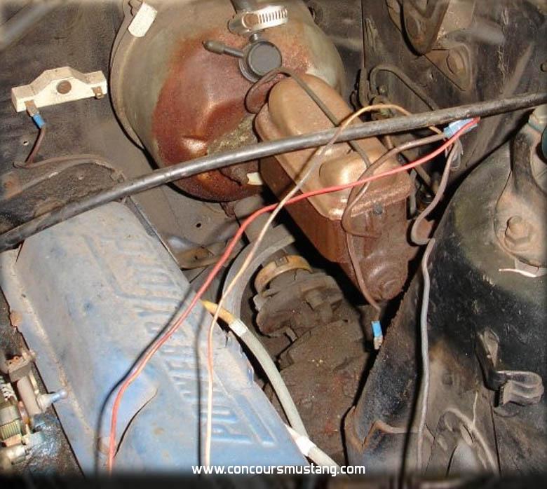

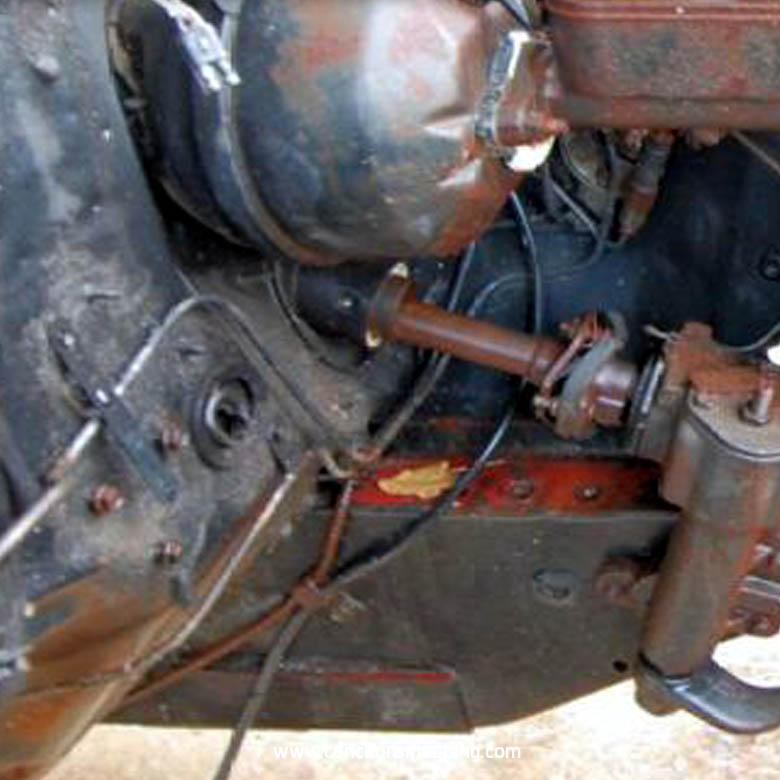

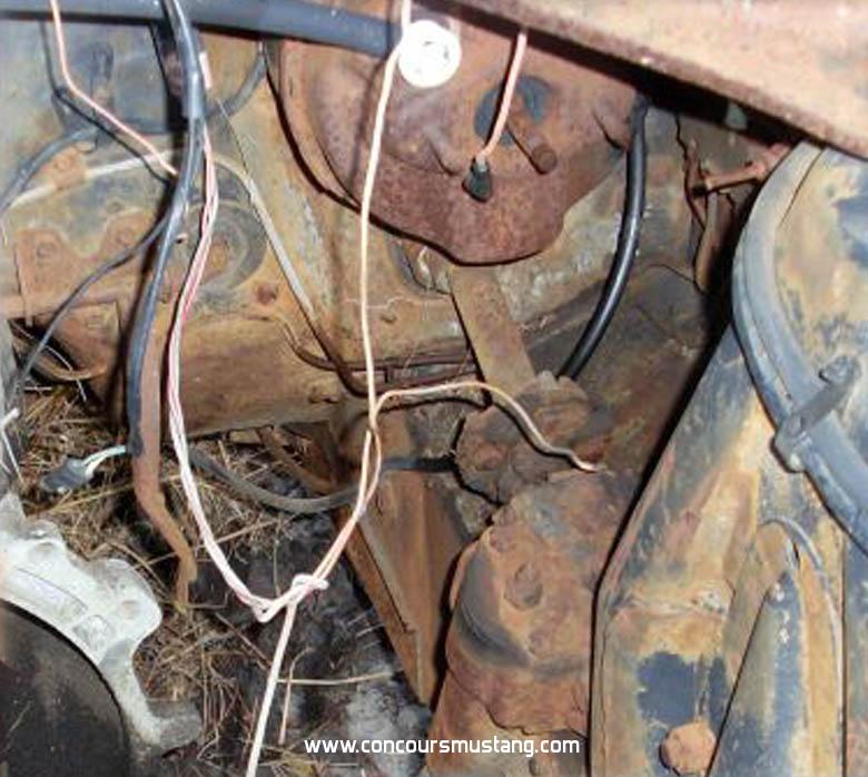

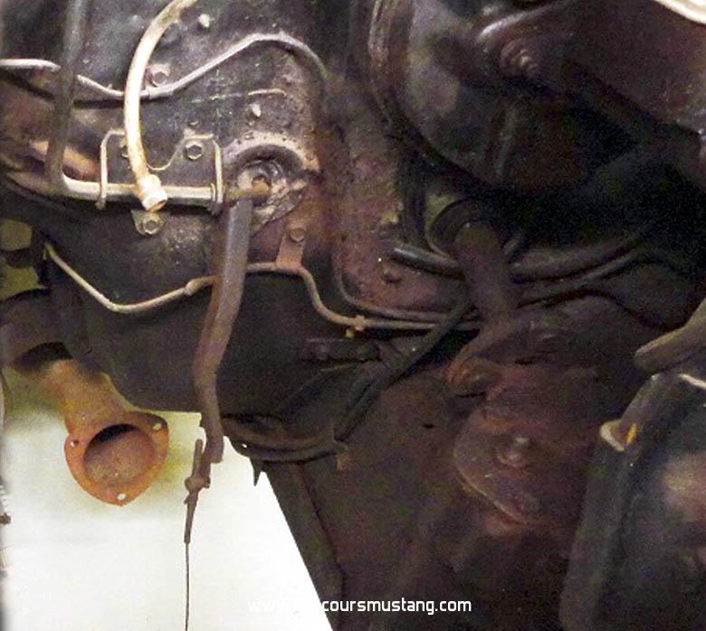

Was difficult to find any pictures in my files where the master cylinder and booster were out (as well as the engine) and the lines were still in place. Might want to compare the assembly manual drawings to the bits and pieces below
Ignore the PO changes  ::)

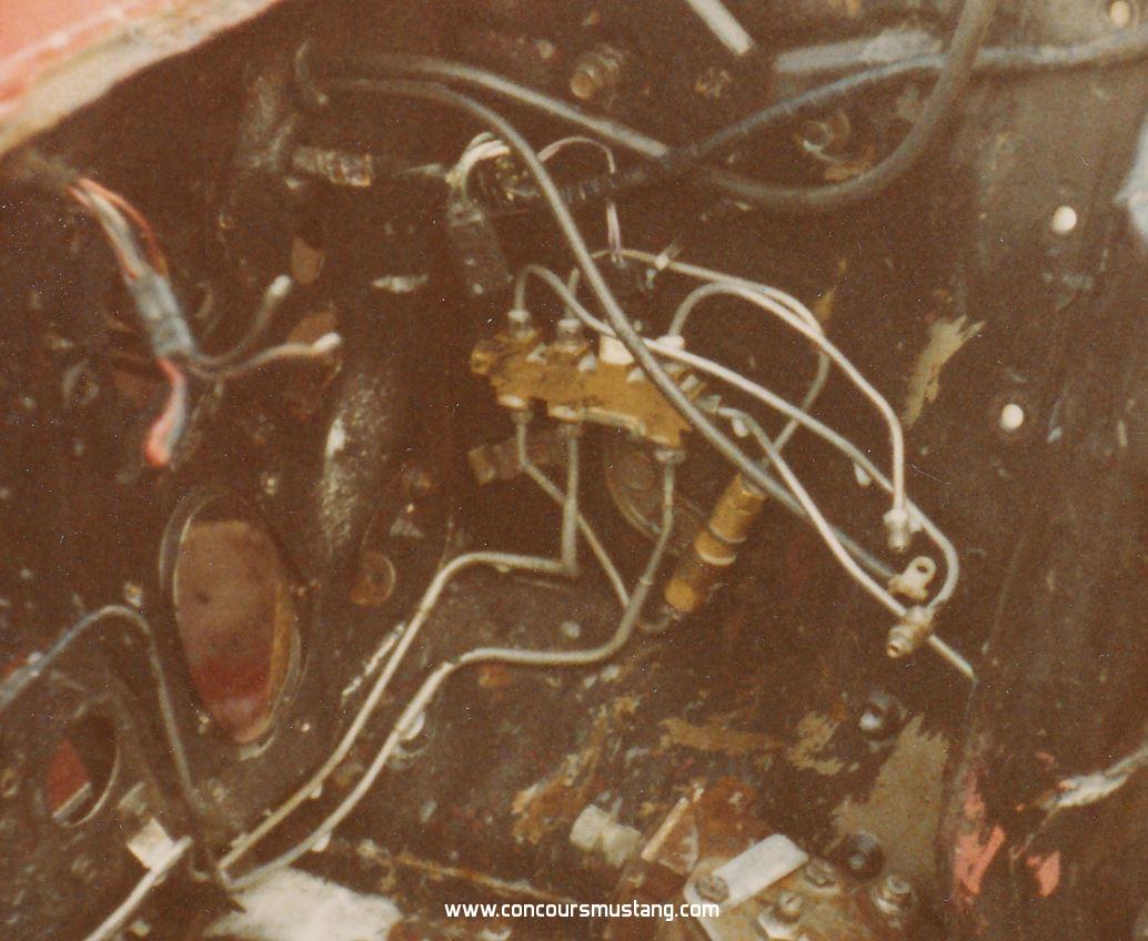

This should be what you are looking for.
Exactly !perfect picture !  Thanks

From your 4th picture you are missing a line. Top and bottom go from distribution block(top) to master. Middle two go between distribution block and prop valve. Should be another that goes from front port of distribution block to LF brake hose
perfect thanks ! no i have its , just install the LF yesterday !

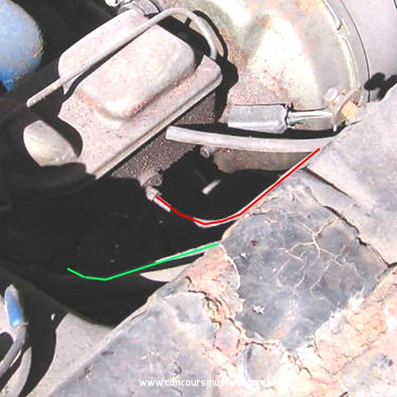

my concern its the picture 3, look like my firewall line front the passager side lines, go too far in the shock tower.... look like the bend its not right ?
