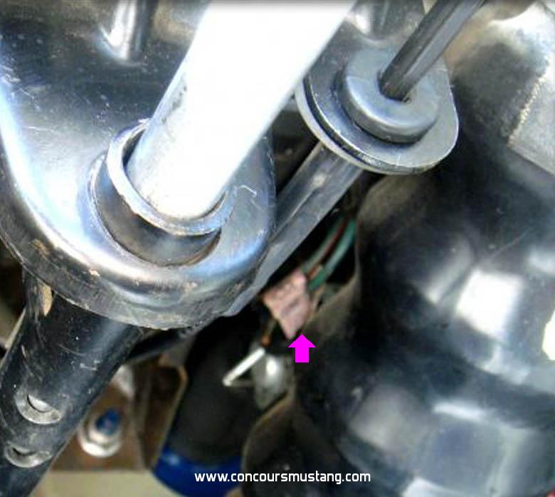

As an offshoot of the 67 Wire Harness ID & Inspection/Assembler's Tag thread I post the following to help others as they progress through their 68 Concours projects. Remember to check the application as it can make a difference in label and location. Often both the identification (often have a colored section to help speed identification)  and assemblers (most often completely white background) location can still be seen on these original looms
Hope these help

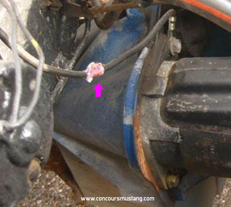

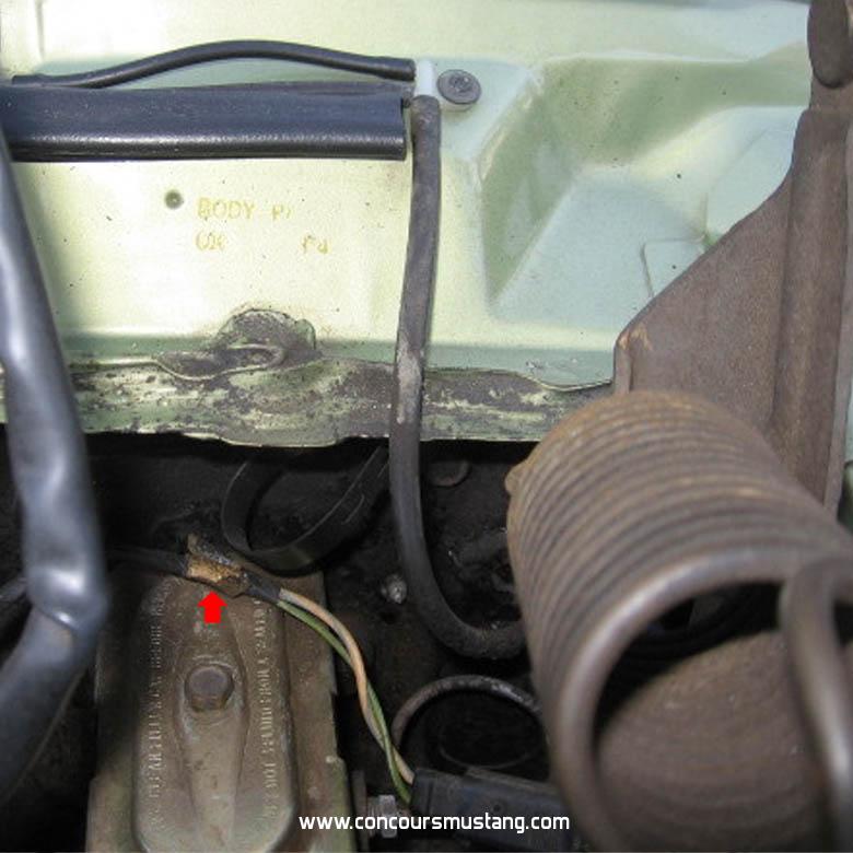

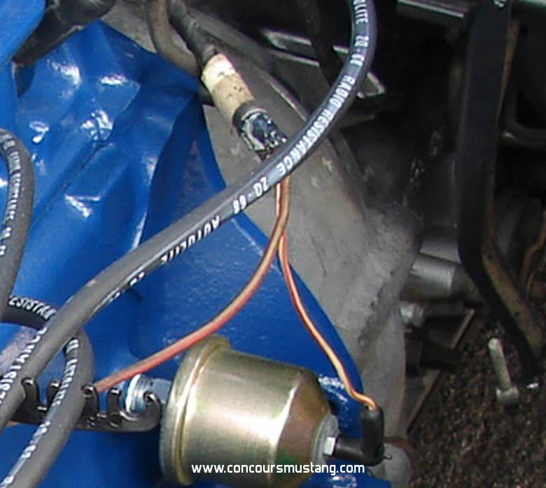

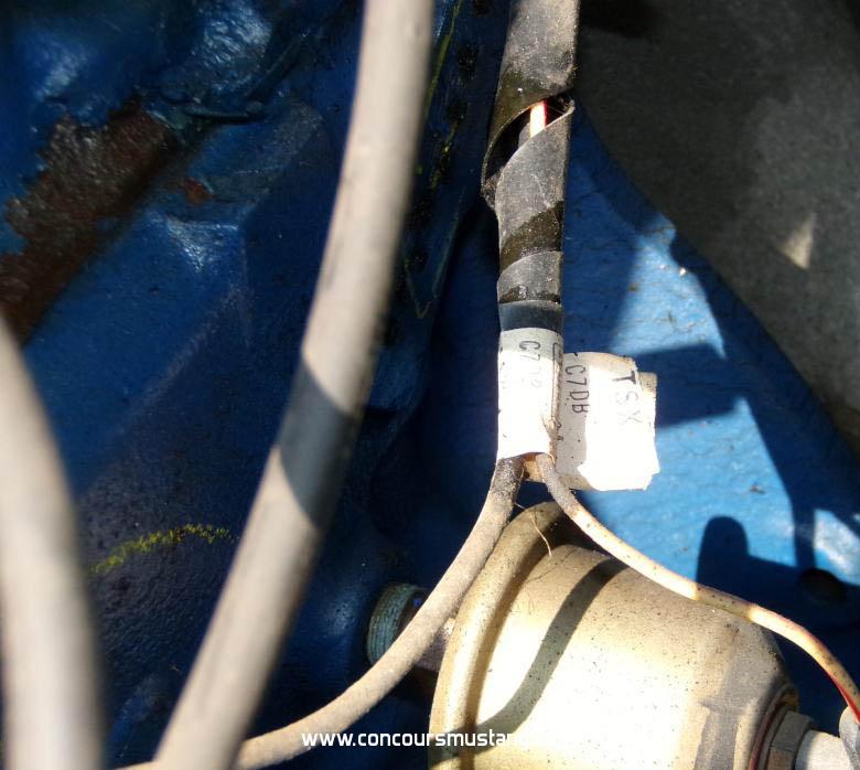

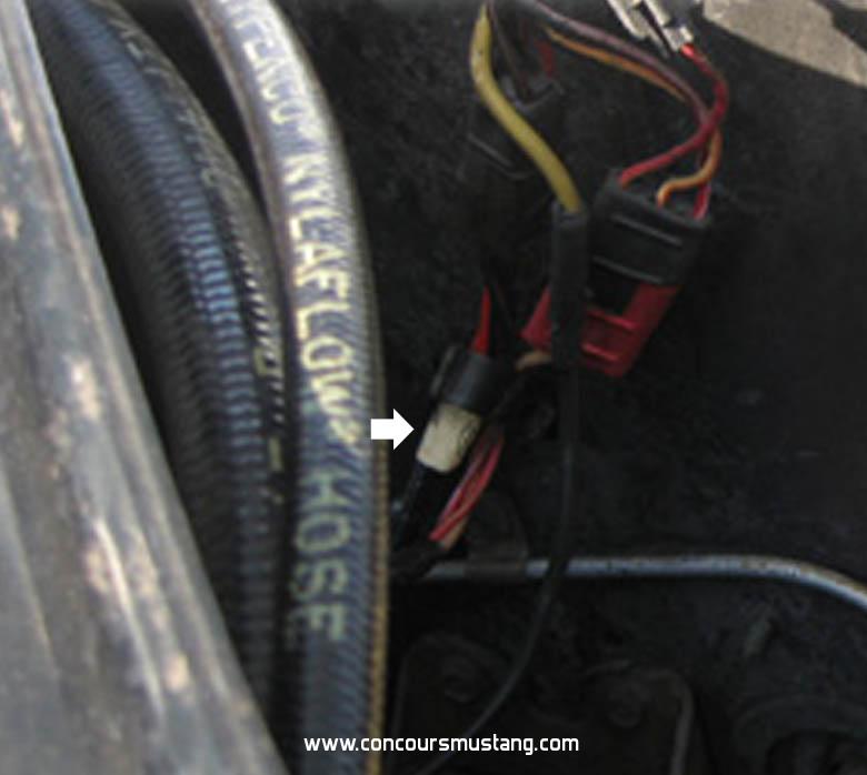

ENGINE COMPARTMENT
8T01T2050xx Hood turn ind loom label. Ignore the AMC/American Motors style master cylinder  ::)

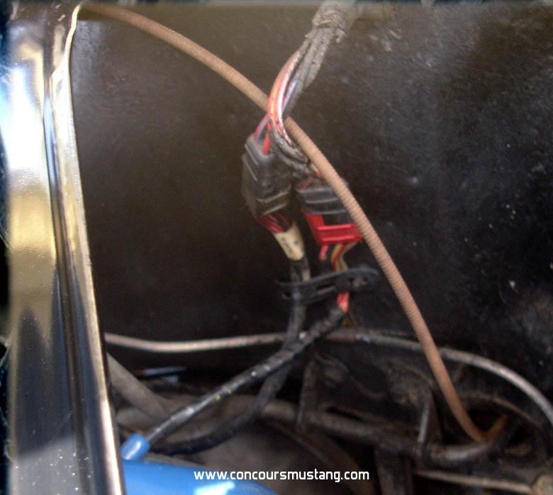

8R02J1247xx Drivers side firewall
8R01C1267xx Drivers side firewall
8F01T2053xx Drivers side firewall

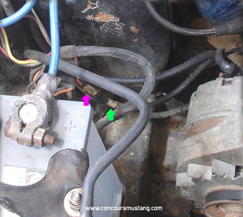

8R02J1247xx Alternator loom
8R01Txx engine feed loom

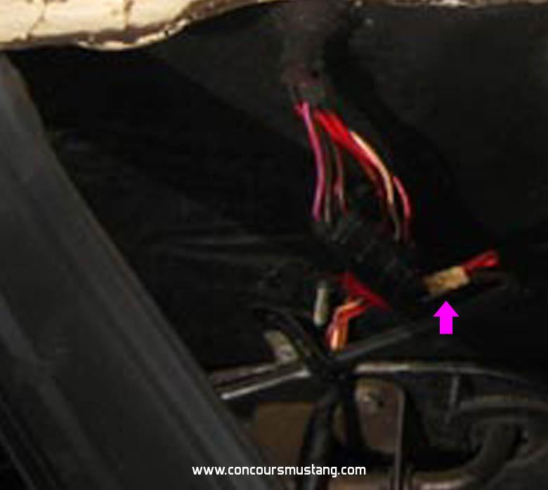

8F01T182xxx engine loom label
8F01T2053xx engine ground

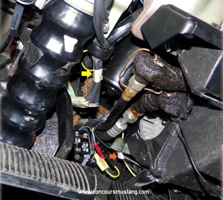

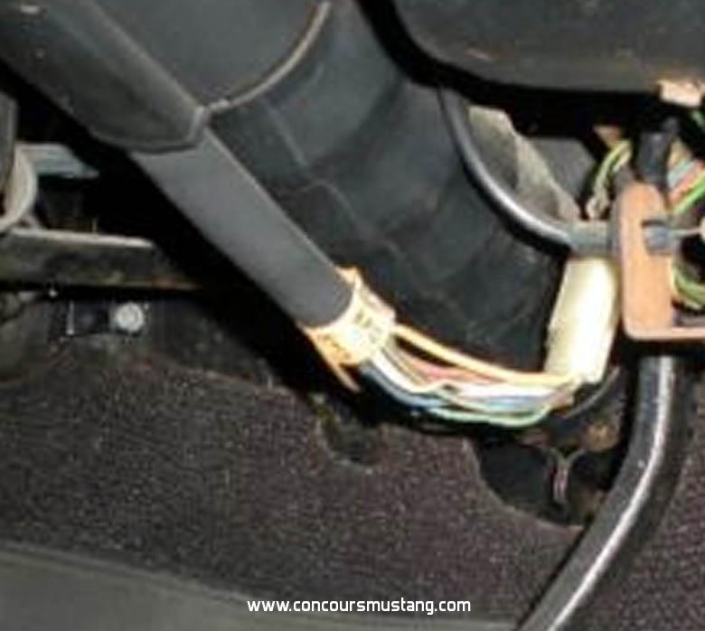

68 Wire Harness ID tags cont.

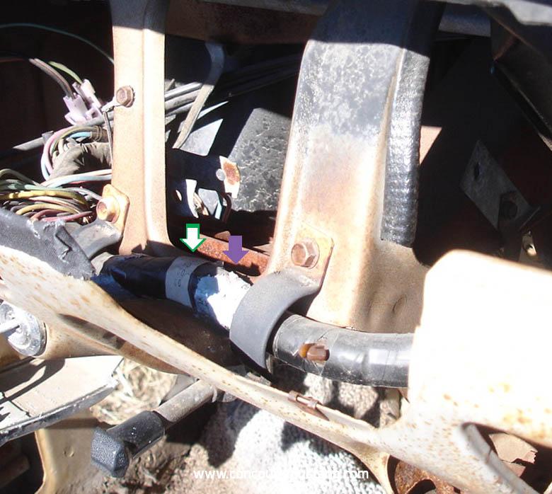

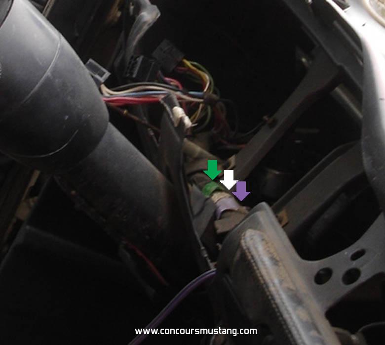

INTERIOR
8R02S1606xx steering column loom
8R01J1035xx Dash loom
8R01C1496xx Dash Loom
8R01C1426xx under dash loom label
8F01T182xxx under dash loom label

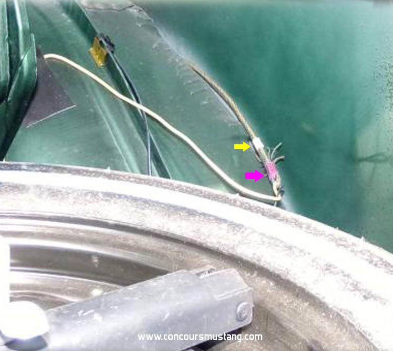

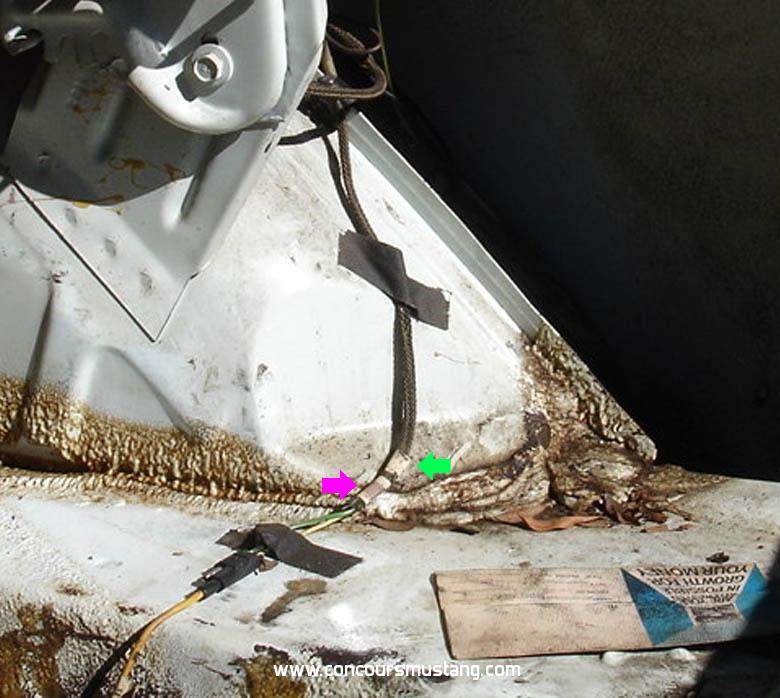

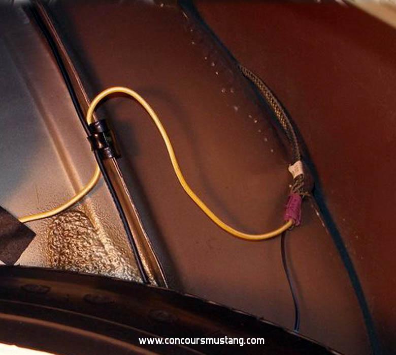

TRUNK AREA
8F01T182xxx Fuel sender loom label
8R01J1614xx Fuel sender loom
8R01C1673xx fuel sender loom fuel sender loom
