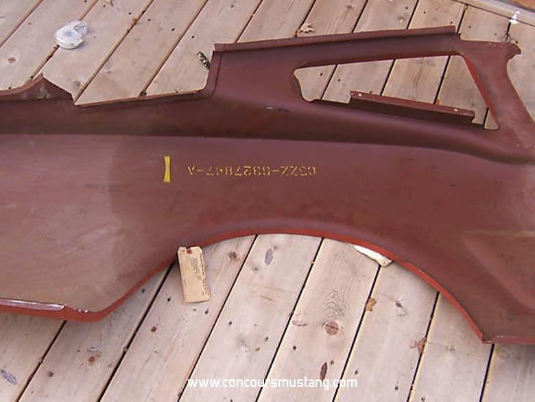

Thanks Jeff. You're suggesting I NOT use the rectangular clip at the fender, just the triangular one. For what it's worth, both fenders are original to the car....stamping dates match exactly and both have ink PNs are present inside the wheel well area.
Both of your fenders have the yellow part number on the inside. Often a big indicator of replaced fenders IMHO rather than originals Might want to look for what might be left of the shipping label on the surface also. Been my experience dates rarely match on both sides.
Have fender examples somewhere - but these replacement/NOS panel examples were handy

Jeff, It's my understanding that you surely know your stuff.... so I respect your comment and will give it some serious thought. That said, the PNs I found on my fenders, to the best of my understanding, are not the service PNs similar to the examples you provided Rather, they're the assembly line or engineering PNs. Every bit of info I have collected for this particular car (15yrs of data collection), including the photos and phone discussion I've had with you, tells me the fenders are the original pair. I am, however, human enough to admit I don't know everything and could certainly be wrong. If someone before me replaced these fenders, they must have gone through a lot of work to find a pair with the same stamping date (matching all of the other dates on this car's sheet metal within one week) -and- they did so with a pair of fenders having only one coat of paint on them, the same color as the rest of the car (I stripped the car to bare metal myself).
