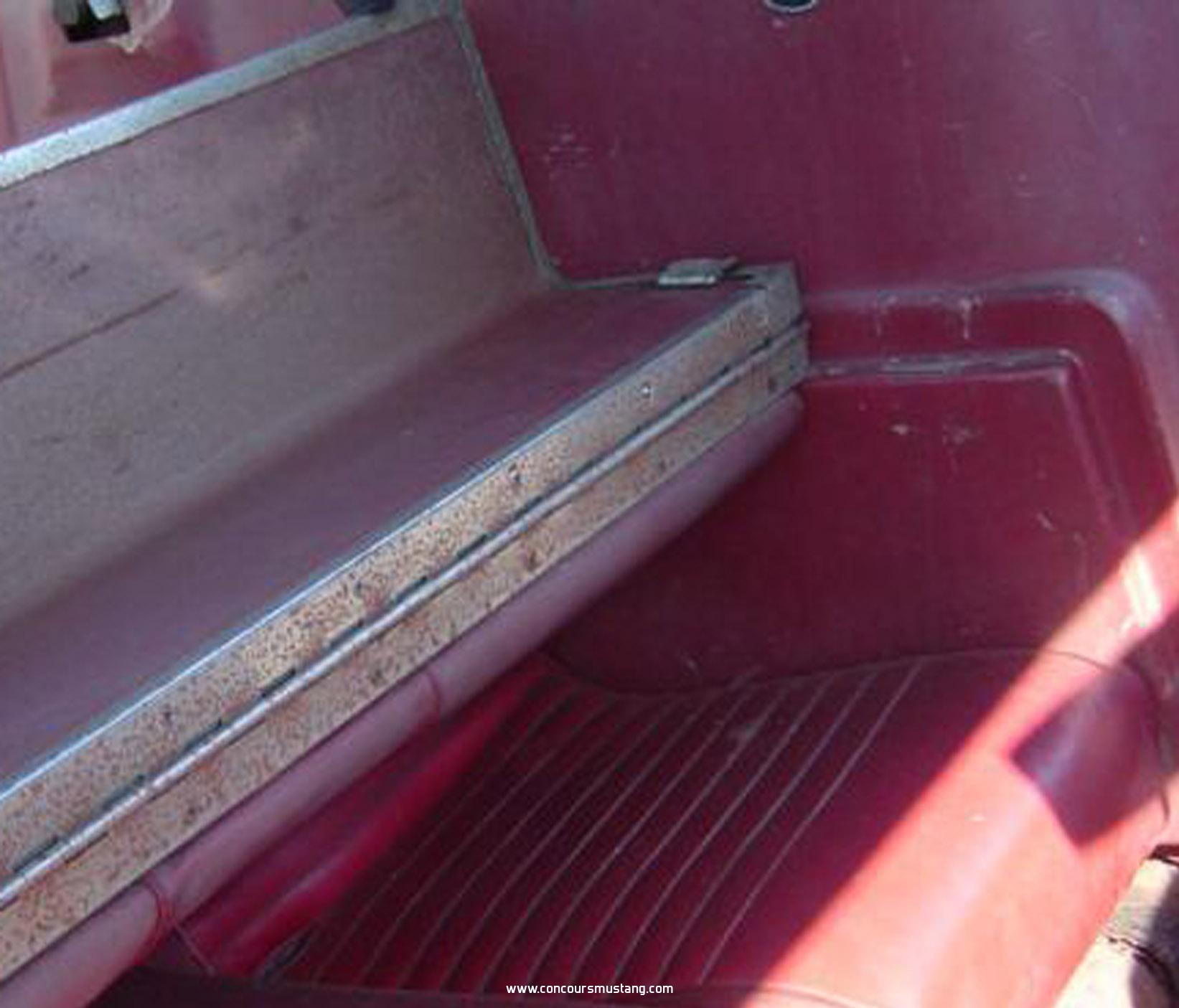

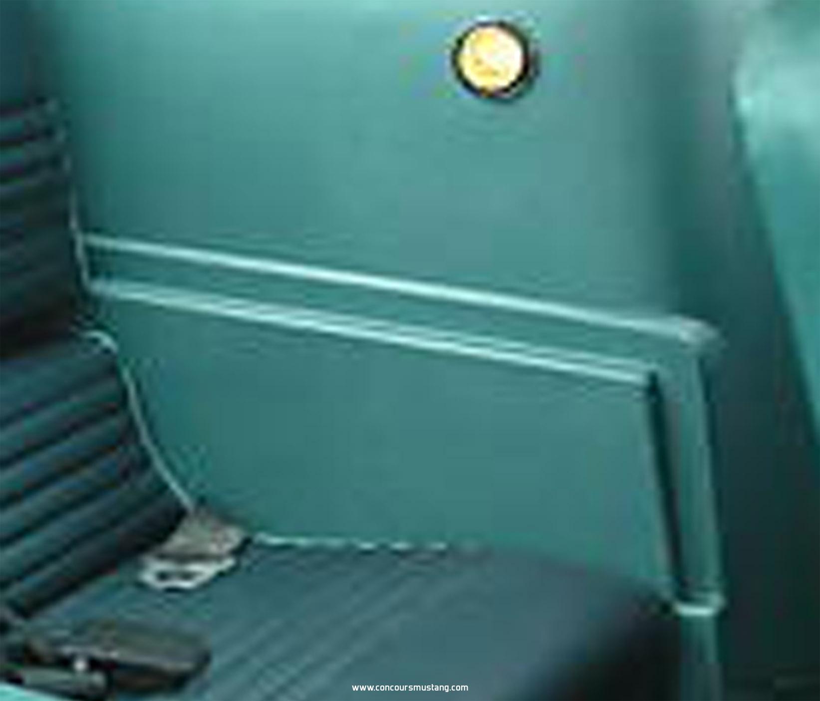

Thanks - also want to check, for myself, to see when NJ changed from the early no bezel at the latch style to the later style that required the trim plate/bezel. For others is appears to be right around the 7T156xxx production period. Earlier than some other plants it appears
Closest clear picture of the area as about from a car built slightly before yours
And an example built after yours. It is a  restored one

Re: 1967 fastback interior quarter panel differences
« Reply #7 on: February 22, 2022, 06:36:55 PM »
Didn't all 67s get the double chrome catch on the fold down?
My 65 has one.
My 67 has two.
« Reply #8 on: February 27, 2022, 08:37:44 PM »
My 65 has one.
My 67 has two.
Believe so on fold down fastbacks. This appears to be what they did until part way through 1970 production
