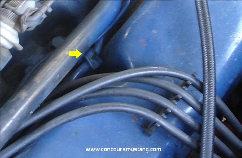

n a 67, Metuchen C code, 289. Does the tab on the harness mount on the middle or rear valve cover fastener ?
The retainer for that loom is a flexible rubber covered metal tab that was originally attached to the middle and front top valve cover bolts on the drivers side as shown below
Note someone has been in the example with a blue rattle can "touching" things up  :(
The harness I have is in pretty good shape. Tape still intact. The only damage is the  brown   rubber connector cover is cracked.  I'm thinking of getting the NPD repro to  get the rubber cover. Does anyone make just the rubber cover?
No and its not worth IMHO trying to fish out the original wires, reconnecting the connectors to the wires and resealing it (making it look untouched)  unless you really really have to. Been there
Most of the time the engine end wires are stiff and brittle or have been repaired because of that at some point. Just my experience
