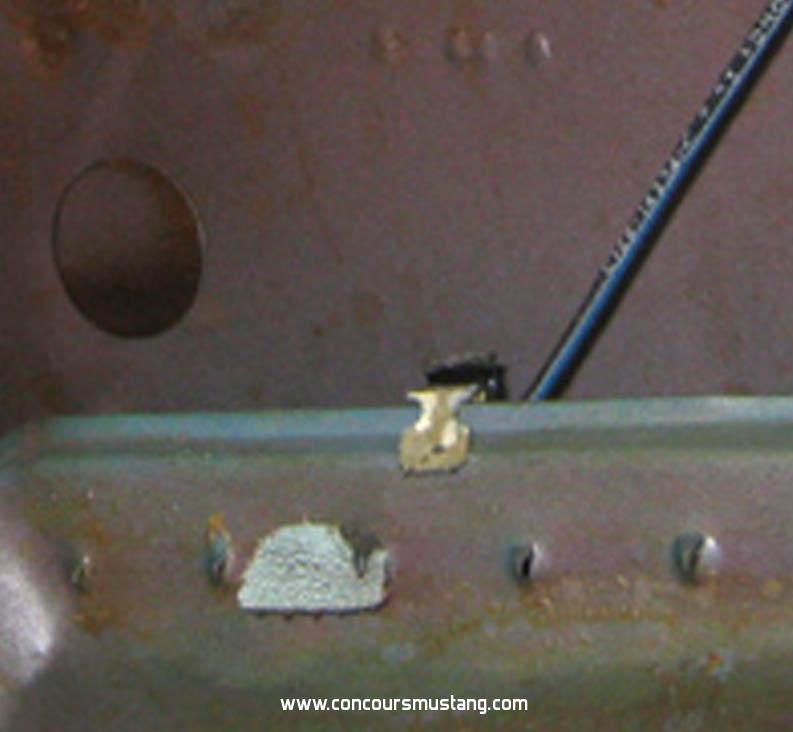

You can sometimes still find one in place in front of the trunk opening attached to the reinforcement panel between the rear window and the trunk opening. The one with all the square and rectangle cut outs in it
Know I've got a couple of pictures of one there  - will look

John that clip is used to hold the dome light wire on coupes.
Thought so too but it is shaped differently then the ones I've seen elsewhere  (67 San Jose coupe application - 7R01C1972xx ) Possible there were other styles used during different times and plants. Only one original example
Will see if I can find the other (different finish and shape) in my collection
