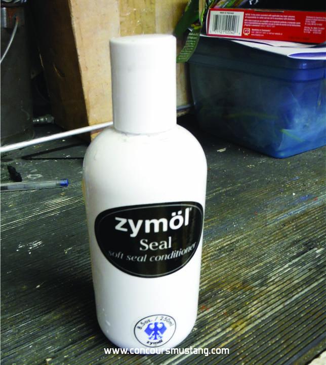

For a number of years I've been using a product but it can't be legally ordered in some areas. Think its based on coconut oil and the European car guys use to soften and condition original weatherstripping. Think I found it through a Por*** web site
Will find a bottle of it and get the name. There is another product I've seen but not used that goes on with what looks like a old style shoe polish applicator.

Re: NOS weatherstrip conditioning
« Reply #11 on: September 06, 2016, 06:29:36 PM »
Thanks Jeff.. Waiting patiently for the name ;)
Ok finally got around and found a bottle of what I've been using for a few years. For some reasons its not legal in Calif to purchase   ::)
Now there are other products out there that others have had success with but I've not had cause to try any of these but will likely when I have a need again
For your and other member's consideration - These are very popular on other sites and forums of other makes and models of cars.
Gummi Pflege Stift' Rubber Care Stick
Dielectric grease in a tube not a spray
Krytox GPL-105, or equivalent

Just ordered a bottle from Amazon.  Not cheap at $30 for 8.5 oz. It contains: glycerin, aloe vera, coconut oil. (sounds like a hand lotion) It does not contain: solvents, silicones, formaldehyde.

On smaller rubber parts I've rubbed some on the surface and sealed the part up in a heavy zip lock bag for a day or two. This will allow you to rub it into the surface and improve coverage and contact. Remember to "burp" any air out of the bag before you marinate the part  :o
Has worked for me but nothing is a miracle
