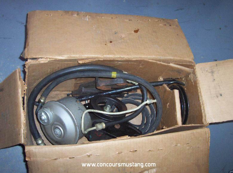

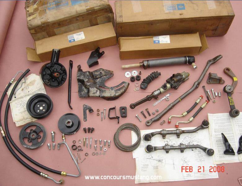

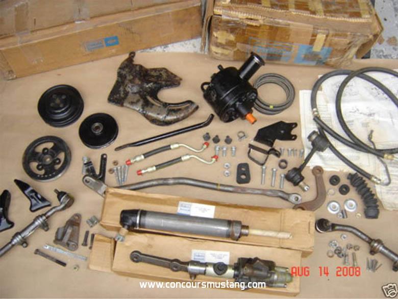

Re: Power Steering Conversion
« Reply #6 on: July 09, 2016, 11:17:23 PM »
.................. Now, with that said, Ford did offer a Dealer installed power steering unit for the Mustang.  I have never figured out what was in the kit. Most importantly was the power steering box included or not? ................
Sorry missed this thread earlier
The "kit" was a combination of many boxes/kits. Have not seen the steering box included but it might be required or spelled out in the instruction sheets
Some pictures of course
