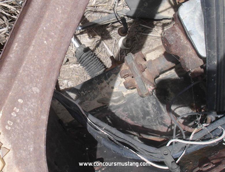

I recently ran into an issue with my '69 Mach 1, where I had a pronounced bump in the steering wheel.  It happened as the steering wheel returned to center.  I checked, and the rag joint had separated.  I remember buying a reproduction rag joint back in 2010 when I first restored the car, and it looked so cheap and flimsy that I reused the original joint the car came with.
Now, I'm wondering if what I had on the car was the original.  Most of the used and replacement/repro rag joints I'm seeing use a rubber disc, but the one on my car was white plastic.  When it broke, the plastic disc basically shattered into several pieces, which led to the bumping feel I noticed in the steering wheel.
I have two questions: Could that possibly have been the OEM rag joint for the car (it's a fixed-column car, not a tilt)?  And what are my options for a good quality replacement?

Not familiar with that particular model.  The one on my car has no plastic and the one sold by NPD, 3A525-20F, doesn't appear to have any plastic in it ?  Brian

The Ford replacement "rag" joint wasn't a layered rubber anymore in the 80-90's, it was replaced by a plastic joint with a metal guard.
The design of the joint I bought was different, but it was a natural translucent plastic/nylon color.
That is not original to the car. I have seen black poly hard plastic replacements before but originals in good to excellent condition are common enough that it is not worth the hassle IMO. If you can't find one on Ebay . I just cleaned up a excellent one that I would let you have at economical price given your predicament. PM me if interested.

A Ebay search under "Mustang rag joint" turns up a range of prices from 23.00 -over 100.00. Plenty to choose from.
