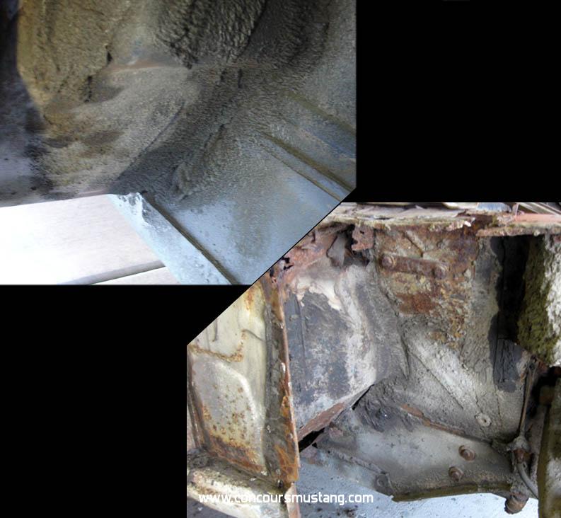

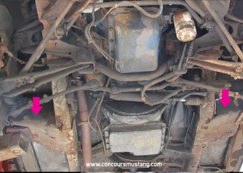

67 S code built at Dearborn January 9, 1967 looking to verify a couple things
1) shock towers would have had re inforcing welds between the lip of the plate and the actual shock tower
2) would have one or two torque boxes

Unless I am mistaken all 67 convertibles and Big block cars got two torque boxes.

They were suppose to
Convertibles only both sides. Other body styles drivers side only

OK Jeff I was mistaken! LOL
