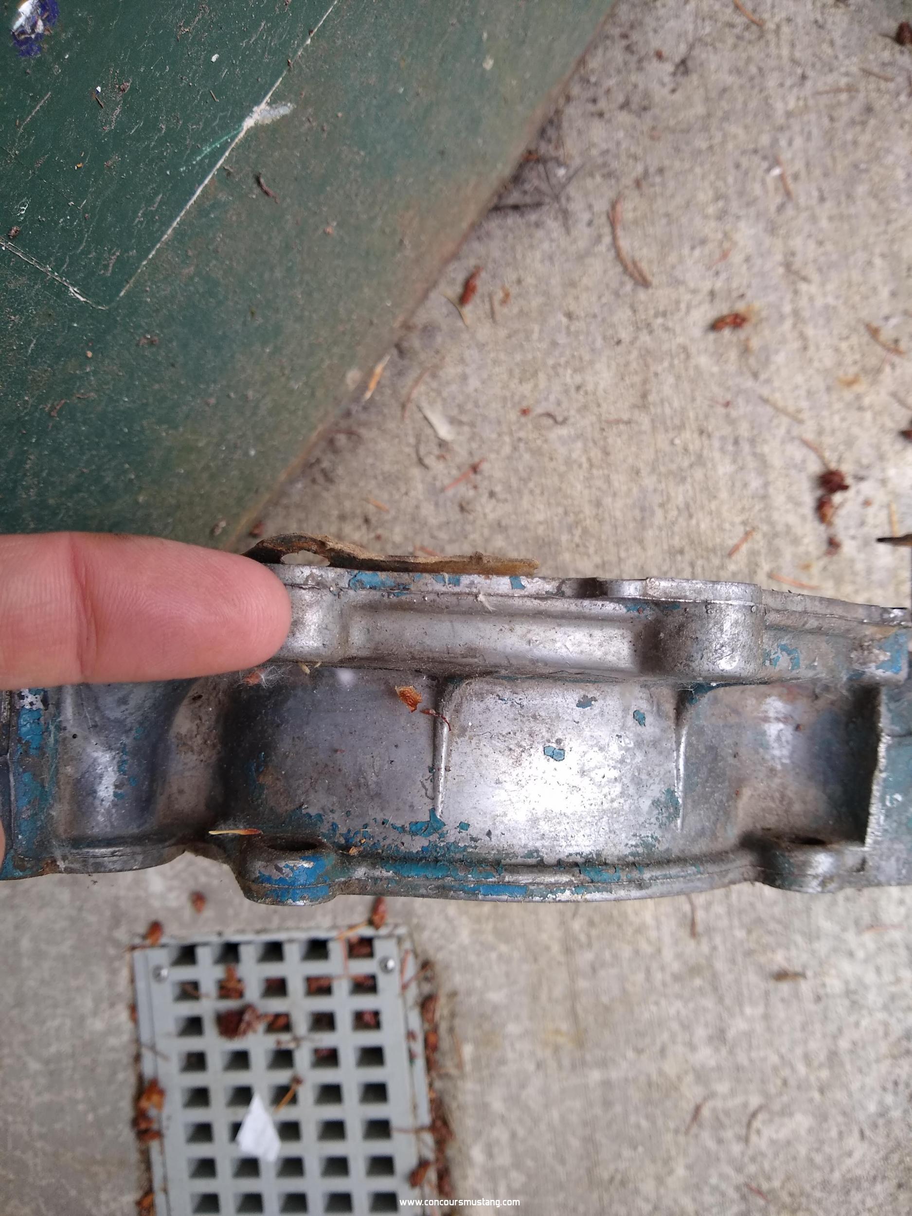

Re: Correct water pump for 64.5 D code
« Reply #7 on: July 09, 2018, 09:43:42 PM »
If the timing cover is this thick:
it's an early water pump style with no back cover on the water pump. The timing cover is the back of the pump.
Offline Hipo giddyup
  • Posts: 1210
« Reply #8 on: July 10, 2018, 10:39:56 AM »
  Here's a pic for reference...
