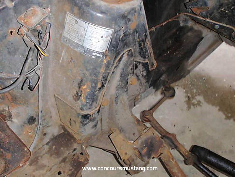

Believe your asking about the shock tower reinforcements
You sure?  Looked through my pictures and I don't see that they are the same in those
Later Cougars (like 69-70) all were suppose to be equipped with the big block style reinforcements - just what the engineers and Ford wanted and a way to save money on the cheaper Mustangs
67 GT big block Cougar example (they look the same as C code non-GT examples I have pictures of)
68 CJ Shock tower reinforcements

Not sure how shock towers that I would not expect to be in production for another 12 months would be available to use at Dearborn.
Picture of the GT engine compartment above was from a April built car
Were these small blocks or big block cars?

Sounds like a few owners may have replaced the shock towers with the current reproductions - with the additional reinforcements that look like the CJs
Apparently you've posted this question on a handful of sites and the unanimous response from the Cougar guys was no- they didn't come that way

I have never seen any Cougar with wrap around reinforcements before intro of the 68.5. Interesting would like to see this. I had a S code 67 GT 4 speed car so will look for the pics. We do know that R code 68 Cougars did not require the GT package nor the Mandatory extra cost option PDB like the Mustang brother. Some are 4 wheel drum non GT.

I realize this is an old topic but this needs to be said in case someone googles it years from now.
Even the '68 big block cars did not have the shock tower reinforcements until late March of '68. When the change happened, all big block cars started to get the reinforcements, including X codes and S codes and the rare late W code cars, along with the R codes. Again, didn't happen in '67 at all.
