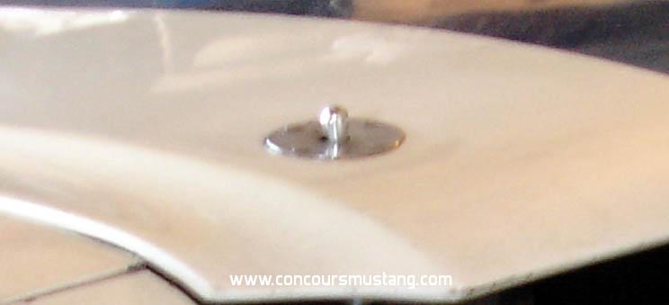

From a car fairly close to yours 12-3-6-9 o'clock
Sorry for the poor picture could get another but think this shows the orientation
Hope it helps
