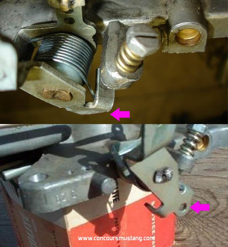

Anyone else notice the bottom edge of the throttle shaft end plate (for lack of a better term)?
So far the automatic examples have a round hole at the bottom and the manuals don't. Maybe its the angle of the pictures but we have a number of pictures posted so far from multiple angles
IF so why did the maker make the difference and provide a hole/loop for an attachment?
Just discussion possibilities and observations ;)
I just pulled these carb images from mustangtek.com... These are both 4100 HiPo carbs, the shinny one is an automatic (C6ZF-F) and the older looking one is a manual (C6ZF-C), and both have the hole at the bottom throttle shaft. Now I don't know if it's different on other carbs, I did notice that one picture in an earlier part of the thread showed what you are talking about.
Also, the way I had it originally with the spring going to that hole on the throttle end plate worked great, so there was no performance issues with that setup, actually made more sense than the spring to the linkage arm IMO ;)
Keep in mind that the throttles shafts can be interchanged when rebuilding. So long as they are from the same type 4100, the 1.08 or 1.12 . I can easily see where someone would swap out the throttle shaft for one that has better plating/condition.
That's why I posted to new carbs not rebuilt or factory re-manufactured ;)

Had an opportunity to actually go out and look last night because I wasn't sure and was curious, especially about that lower hole being discussed.
We also have the same setup as Jim's #18 posting. We have that lower hole (the item I couldn't remember for certain). I think I've rebuilt this original carb at least 4 times over the years and I know I've never changed the configuration regards to bracket, spring and where it attaches.
