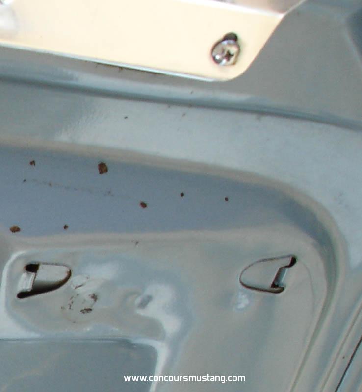

Here are some close ups from one example
Look similar to what I'm seeing (gap around some mounting screws but not all) on other cars though adjustment vary
All covered - partially covered?  Both correct on original cars IMHO  since there would have been slight variables in the production of both pieces give or take 1/32" or so ;)

The aftermarket trim piece is more of a sharp point where the edge of the hood fits so it really doesn't fit well and that's why the holes don't line up.  I found an original and it is more rounded where the hood edge fits so it goes on all the way and lines up with the original holes(in an original hood).
