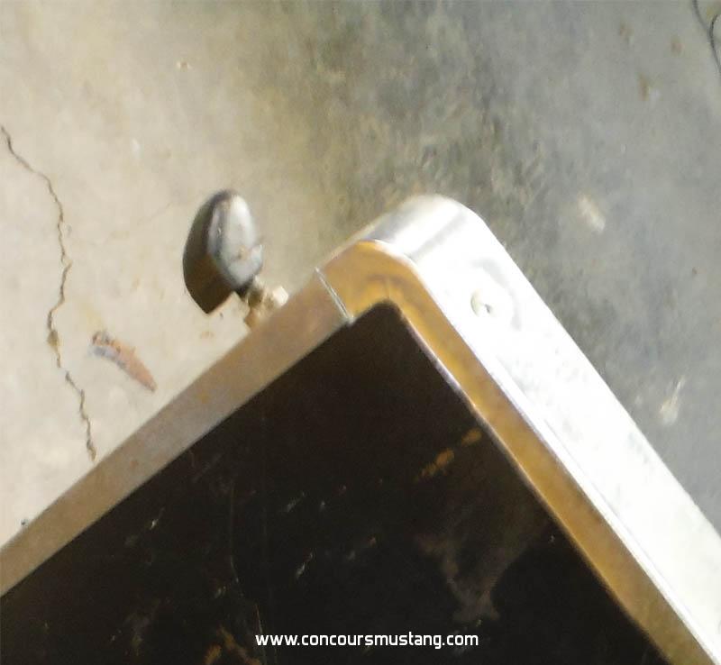

One of mine is missing, and the other is round.  Is the attached picture the correct, original bumpers?

That is what I have on mine
When and where was your car built?

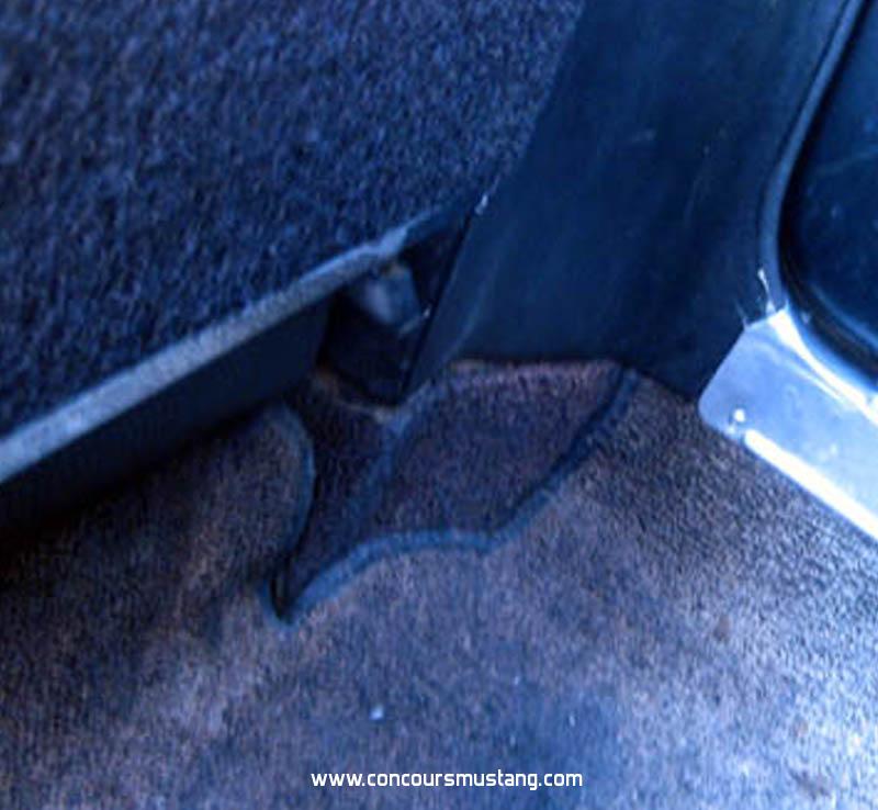

San Jose....May '66.  It had screw in with round rubber covered ends...see attached photo.

San Jose....May '66. ..
The style in your first post is what your looking for

Thanks...looks like PO improvised with the ones installed...I've installed the correct ones.

I've seen this before in another car where they used the hood bummer stops and used them for the fold down seat bumpers... kinda looks like that to me from your original shot, could be wrong though...

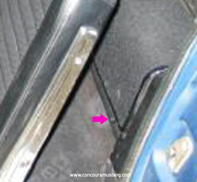

I was wondering what you guys were talking about ?  Thanks for the pictures and where to look.  So... the 65's are totally different ?  Brian
Since the rear carpeted section does not have pockets in them like later years (chrome bracket that sticks up from the surface instead) the bumper is shaped differently and contact is made at a slightly different angle. You will also notice that the bumpers are more outward (in relationship to the body and along the fold down section
There are a bunch of different details related to the early fold down assembles. Some due to rattles owners complained of some for other reasons
