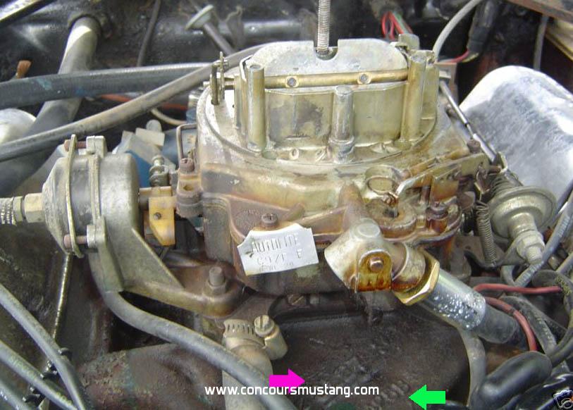

« Reply #3 on: April 13, 2017, 09:13:36 PM »
Purple arrow - is where the date code will be found. This one has a November 27, 1968 date
Green arrow is the engineering number - you can make out the last part of the original letters/numbers ;)
Agree with Andrew that you are likely assuming that the 69 S code intake has features of the earlier intakes.
