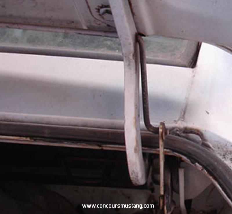

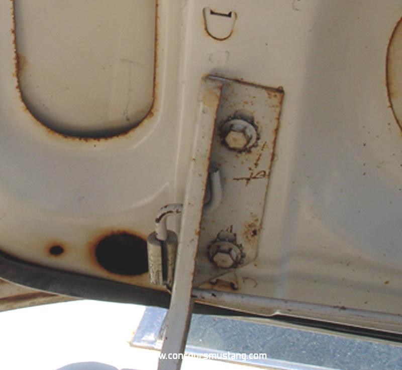

Not sure where there are two mounting holes for the rod to pass through, maybe I'm missunderstanding but thought some pictures might help while I'm in the 67 fastback section of my pictures

Ok the red car photo seems to replicate my trunk the linkage bar to the right hand side seem more vertical than mine so that might be the problem I will adjust the linkage in the morning and take a photo and show you how I get on Jeff
Ross
