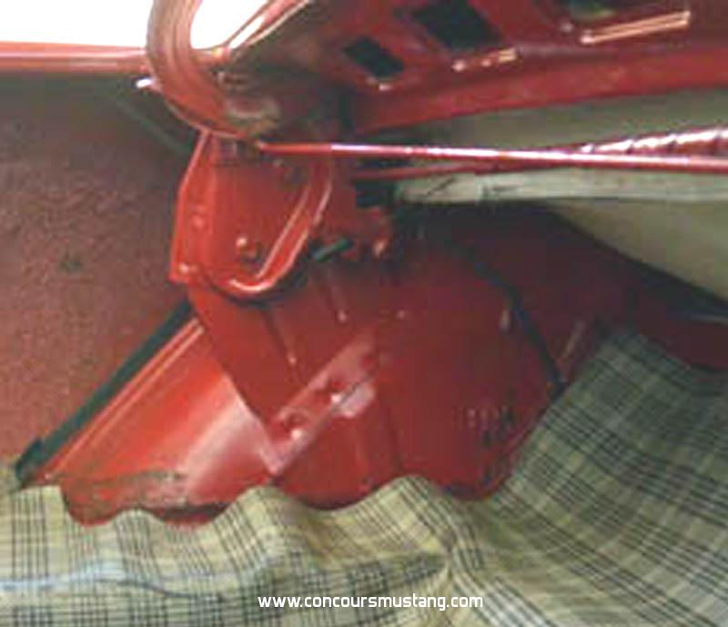

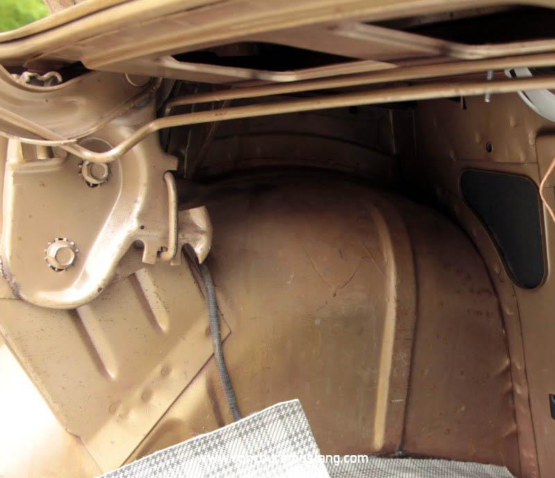

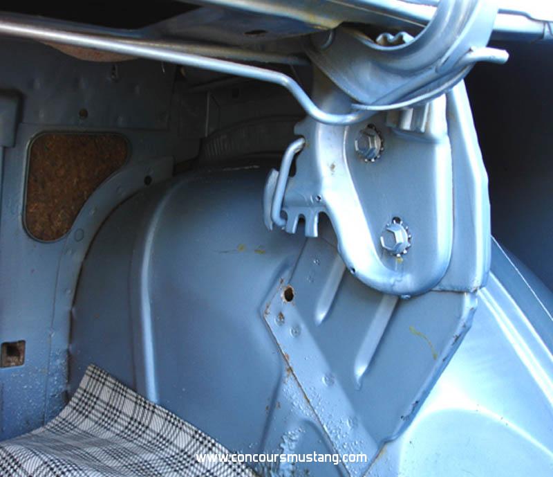

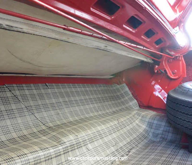

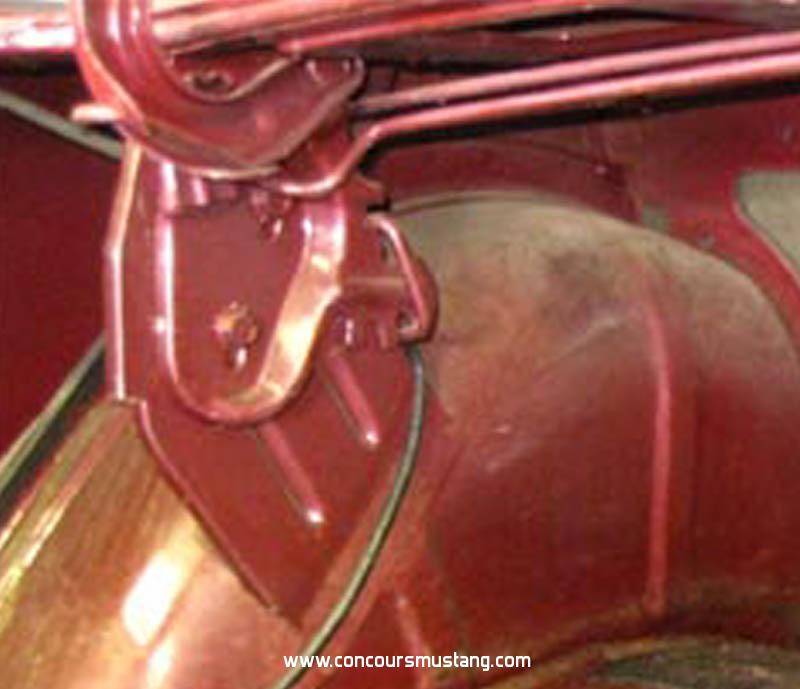

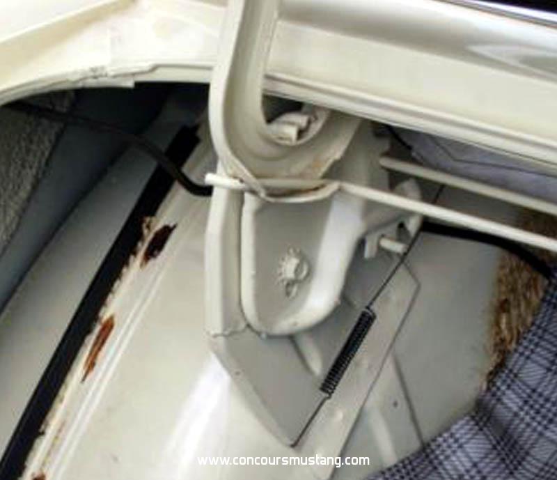

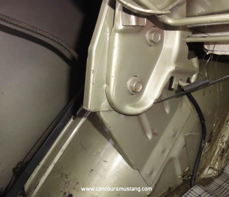

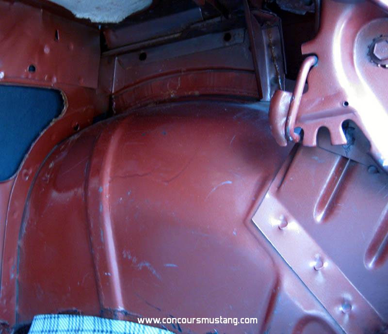

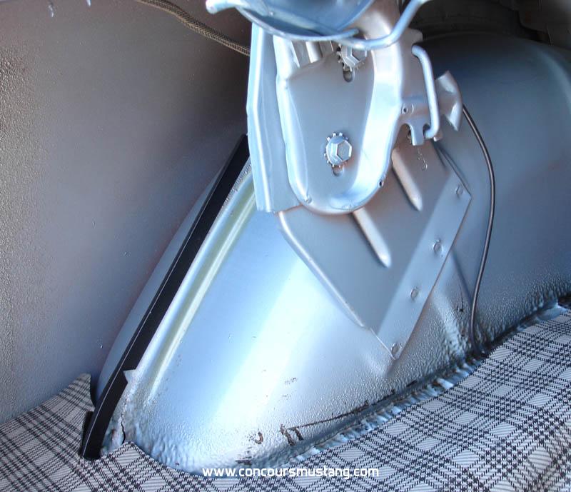

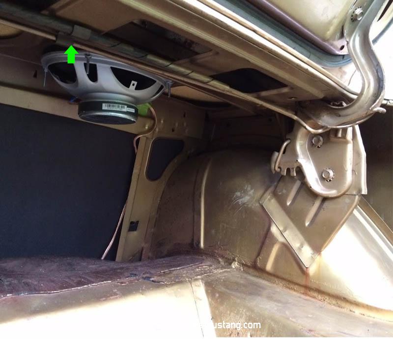

So here are some examples so you can draw your own conclusions
On coupes the two rods are held to the body midway between the drivers side and passenger side trunk hinges. On convertibles there thewre is no midway unpainted retainer/bracket
Coupe
Convertible
Comparison of hinges and rod locations
Drivers side coupe
Drivers side convertible
Passenger side coupe
Passenger side convertible
