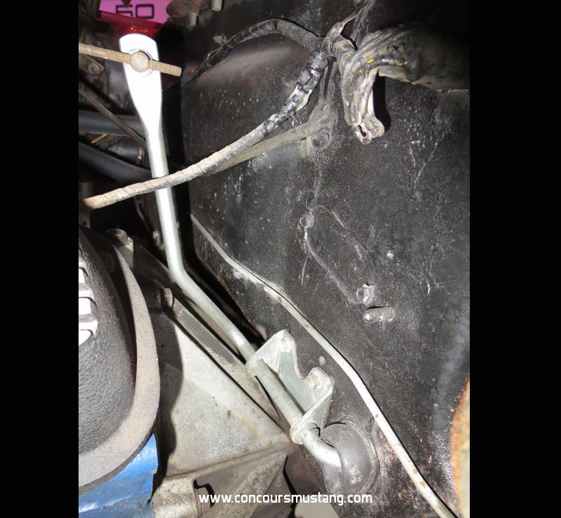

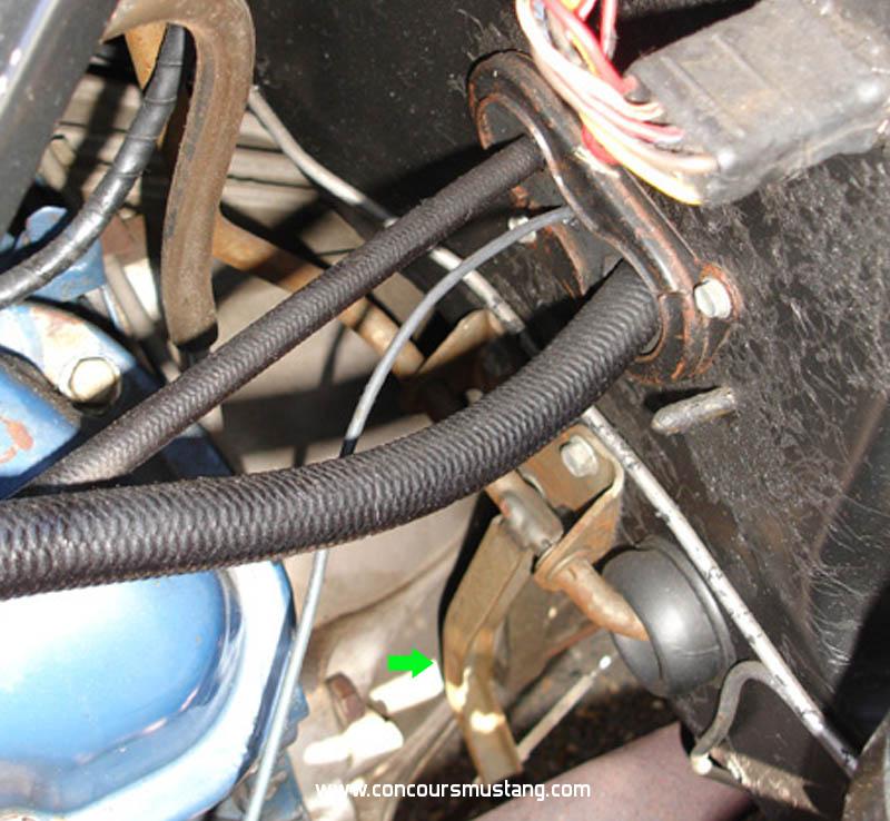

Seeing that in the past you referenced April-May time period (might want to put some info in your signature ;)
Here is what is typically found on an original car
V8 - With manual transmission
V8 - With automatic  transmission
Noticed the (highlighted) lower arm on this throttle bell crank or arm compared to the one for the manual transmission cars

The 66 shop manual likely has the adjusting instructions for the cable at the end of the throttle arm (lower picture above) to the transmission arm. It would likely not show the 64-5 style you have currently installed.
Not sure what your seeing that suggests that it looks original.  Care to share something that might not be in the picture you attached
