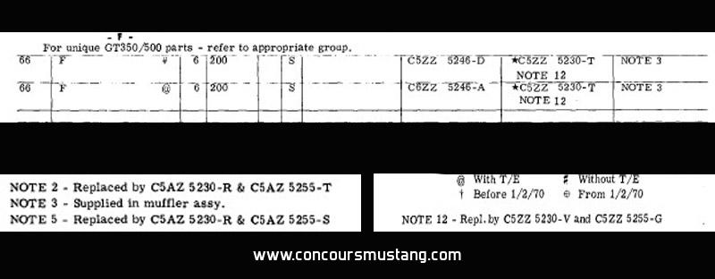

Re: Six cylinder factory single exhaust question
« Reply #2 on: January 17, 2023, 08:21:20 PM »
Understand that we want to help members learn about the features and location of information here on the site so that they can help themselves and possibly find the answer on their own or at least start their research. Thought this might be a good time to mention a few things and voice some possible concerns about this specific question.
One concern about applying what you see in the later versions of the MPC is that by that time many parts have been replaced by other service parts so read the text also and the note. When installing and designing service parts consideration sometimes needed to be reflected in the part design since those were going to be installed differently that they were originally on the assemble line with different parts not installed yet. In this case the rearend
Looking at your specific question by 70 the assemble was a two piece assemble and the rear - muffler plus had already been replaced with a service part  in that particular copy of the  MPC  Note also states that the muffler is included (welded) to the muffler) so that the whole system is identified as two piece
Also note that the inlet pipe is different depending on if the car was a Thermactor or non-Thermactor car
Scans from a couple of pages to illustrate the information mentioned above

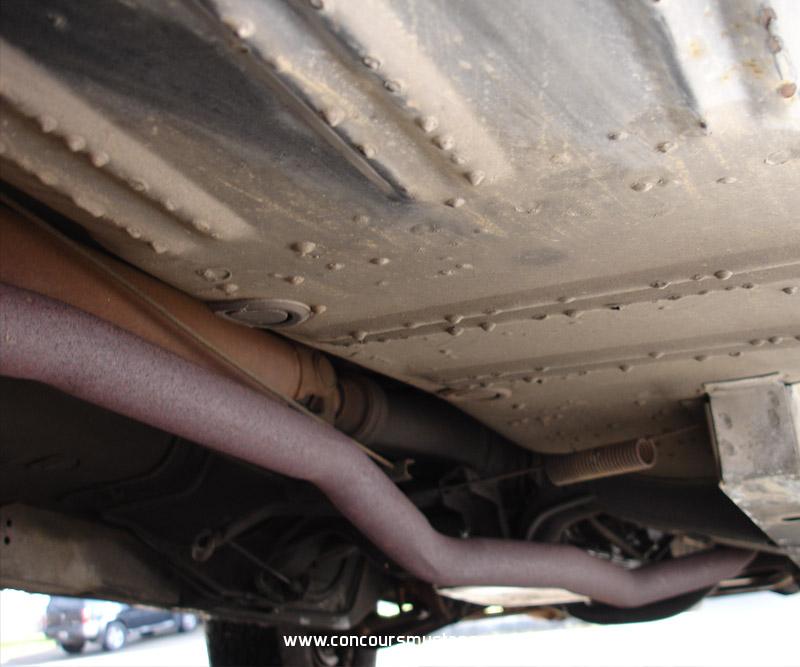

« Reply #5 on: January 18, 2023, 12:20:58 AM »
What I am trying to decide is whether to have my muffler shop created a new one piece pipe from manifold to muffler or leave what I currently have which is the two pieces welded together. This weld happens to be at the convertible reinforcement pan btw. Finding nos or correct originals like those more readily available for a v8 for my little 6 cylinder convertible is very difficult sadly.
Not sure why originally they would have made a two piece tube. Here is what should be the C5 intermediate pipe showing that area where you state yours has two tubes joined. Looks like this one is a single piece. Yours, like others may have been repaired at some point and it was easier/cheaper to just replace the damaged section
