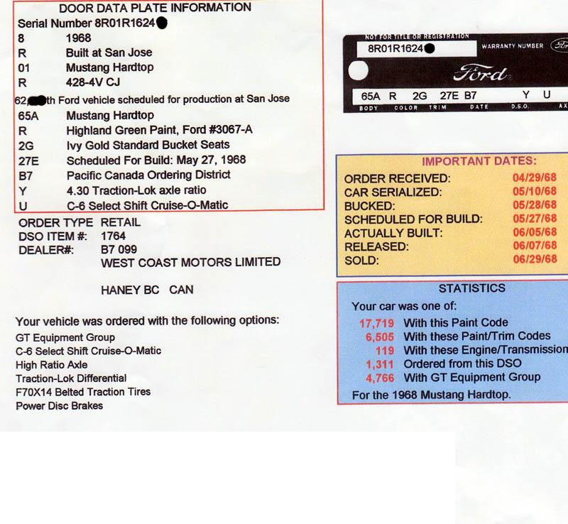

Just curious if anyone has actually documented the canada w/o smog ?
I feel pretty confident it didnt happen for Shelbys

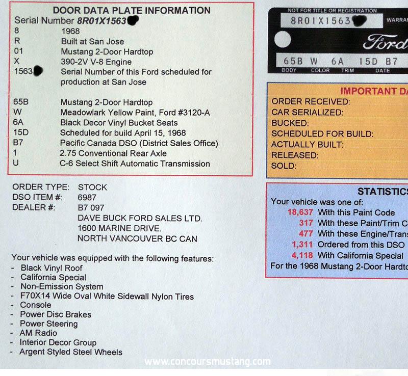

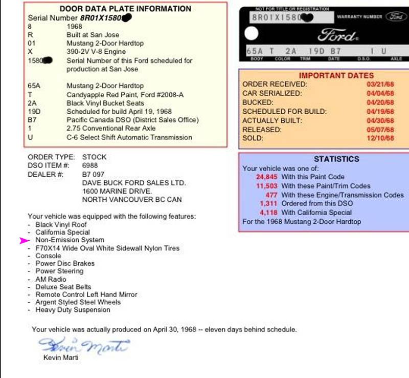

Yes both with the Thermactor systems and other systems in 68. Likely have others but here are two examples (non-S codes but guessing that does not matter to begin). Also have examples were the emission system was not listed and likely like US cars
Not sure what they changed on a X code to remove or not include an emission system but here it is
Examples ordered from Canada that did get their US emission systems it appears from the report
And another X code Same ordering district. Maybe it has something to do with where the cars were going to be delivered not where they were ordered from.  Just a thought or possibility

Yes it IMHO indicates that the car was equipped with the standard features for that engine and transmission type and fulfilled or exceeded the requirements in the country it was ordered and planned for.
Since it was not an option and it was not deleted the standard practice for Kevin has been to not list things that were "automatic"
Heater is not listed unless deleted, standard wheels and hubcaps ................ are not listed.
Emission related - If a J code 68 has an automatic or manual transmission (for others one would get the IMCO the other Thermactor) the difference in required emission systems is not noted since it was part of the engine ordered. Seems only things out side of the basic car or federal requirements are by example.
That is the way I'm reading the information available
