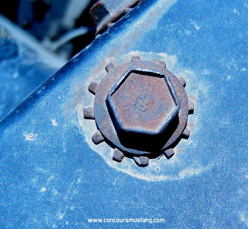

Just as a reminder the date on the door tag/plate is not the completion date fro your car (likely) but a projected date. The date the person entered into the system as a guess when your order was received at San Jose and assigned a VIN
Looking at unrestored cars around that time with the tooth washer I found this example. Earlier and later they went to the smooth disc style for a while
