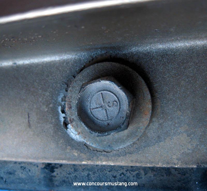

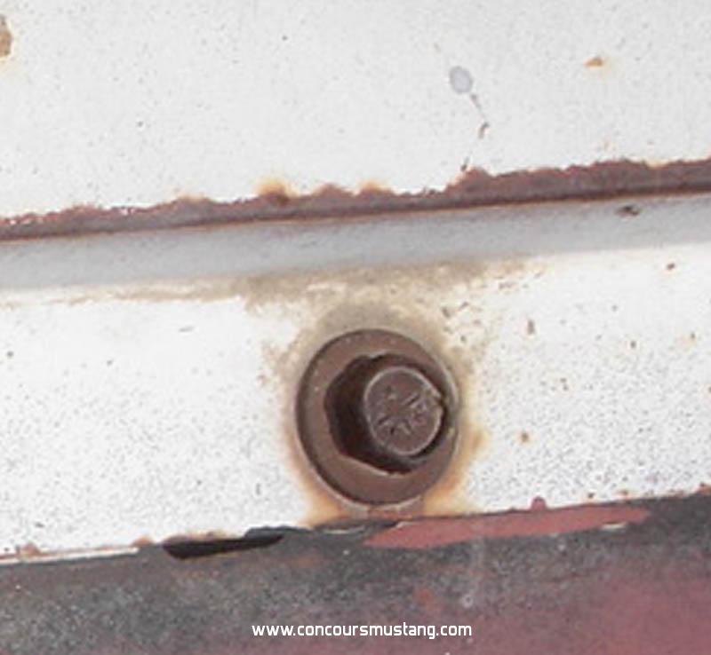

Took a look at my collection and I found two head markings used.  Pictures with corresponding VINs below
Seen more Sems with the T in the circle through out the year but that is just me. You will find them also on 68 San Jose
9R1110xx
9R1115xx

Those were used on dearborn cars for sure and they are on my 69 fairlane convert, kansas built.  The bolt Big S Jeff shows are on my old SCJ drag car, san jose early Jan 69 built.
