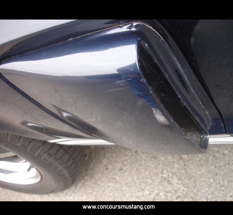

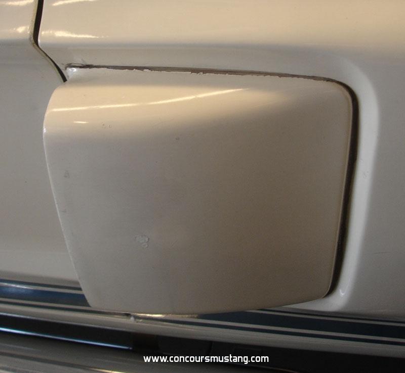

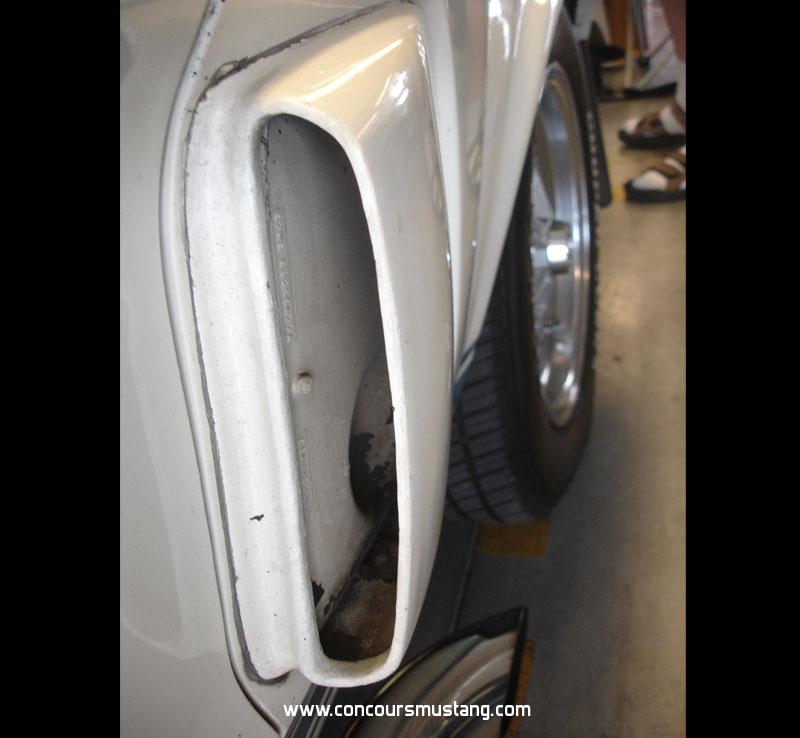

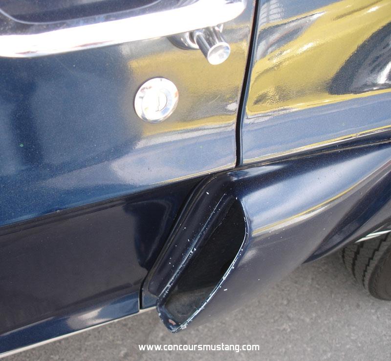

Do you have any pics of the scoop and what the general fit is supposed to be?
Just the first half dozen or so I ran across - Just happened the most were dark blue
Remember there is a small bead of sealer that is applied between the two surfaces but its not there to fill in big gaps or flaws in the scoop

On Jeff's pics of the white car I definitely see dark gray sealer. The blue one looks dark gray too.

No dark gray sealer. It is clear silicone(RTV in the documents). Clear silicone sometimes darkens when exposed to dirt and dust with age. The scoops ,nose and end caps get the clear silicone.

Wow! That white one really got dirty!
