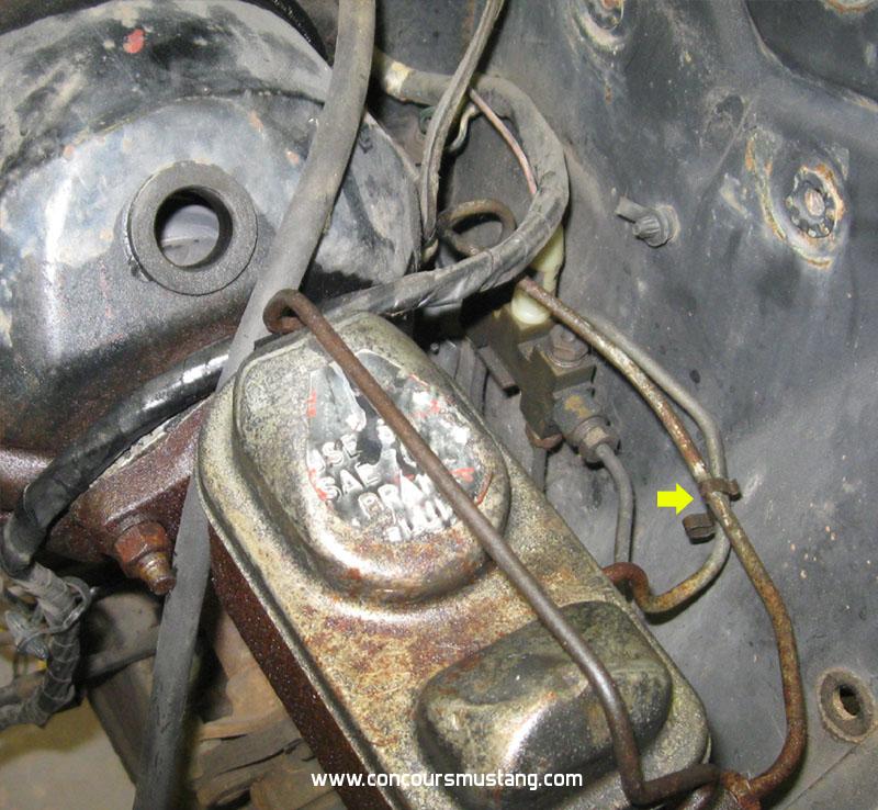

Two of the (what we're calling) the "3" brackets
Between the two brake lines next to the master cylinder - 7R211xxx

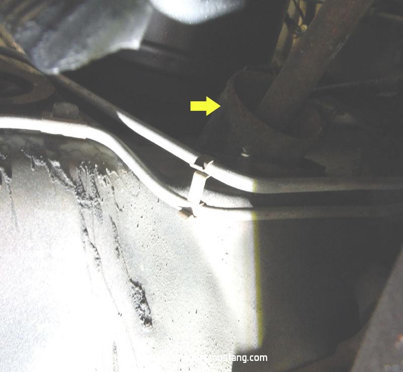

Below and to the inside of the steering column (yellow arrow) - 7R207xxx

Interesting. Thanks for starting the later 67s 3 clip issue.
Evidently if you have brake lines under the column (reported by many vendors as occuring 2-1-67) we find the second large 3 clip under the column.
Not home to check other sources to see how earlier cars handled these two lines at that location.

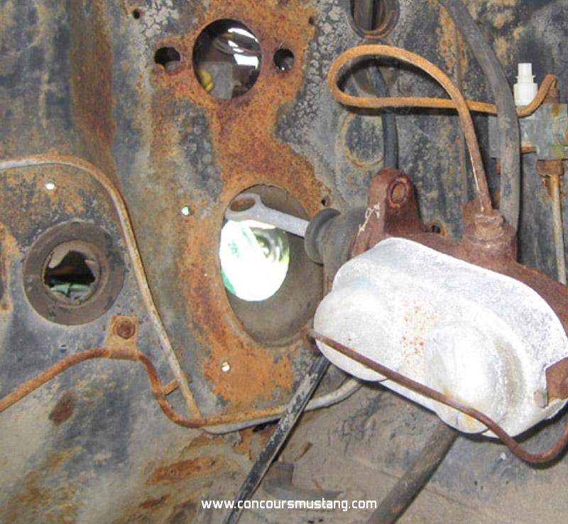

Another example of the under the steering column routing nearer to the change over period
7R01C1892xx
