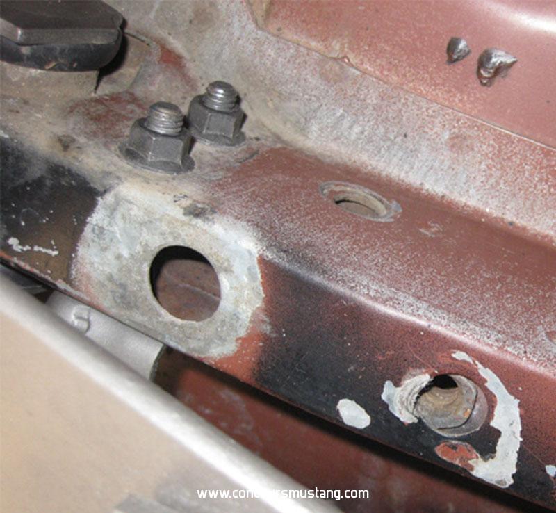

Hello all, been removing under coating (worst job ever, haha)... Anyway, I came across something that does not seem correct. The very rear exhaust hanger bracket is literally welded to the rear frame rail at two points. There is one nut and correct bolt, and then what appears to be two tack weld point at the bottom of the bracket to the frame rail on both sides. See my attached image, I've circled the area showing where the two tack weld are... this is not correct right? I assume this was some shabby work done by someone at some point, I just didn't want to tear it off before confirming this wasn't something just done for some reason at certain times. But not sure it would have since the point of these brackets and bolts is to be able to move them up and down for exhaust alignment.
I'm pretty sure I just answered my own question but throwing it out there on the off chance this is some weird anomaly...
Car is a 1966 GT K-Code, February 10th San Jose.
Jason
The bracket that attaches directly to the frame for the dual exhaust is attached with two carriage bolts only originally.  Each has a flanged nut that tightens and keeps them in place. The bracket would not be welded to the frame nor would that allow the adjustment of the bracket as it is designed
Will post a picture in a little while to illustrate
Thank Jeff, this is exactly what I assumed but just wanted to be sure before I tore it off and grinned down the tack welds. It didn't make any sense to me since I knew they were supposed to be able to be adjusted up and down.

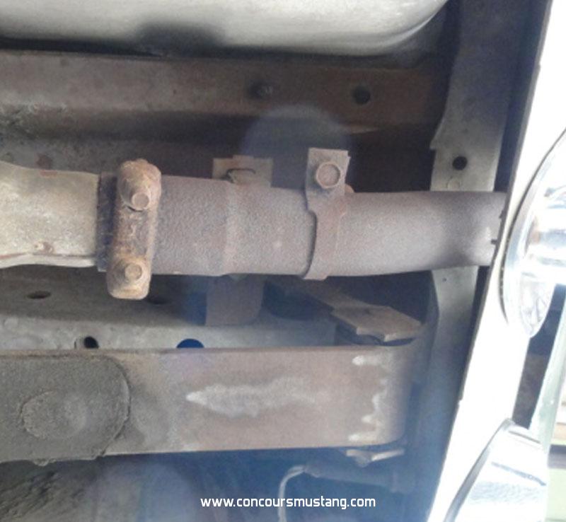

Though lots of things to get in the way of pictures a few as promised

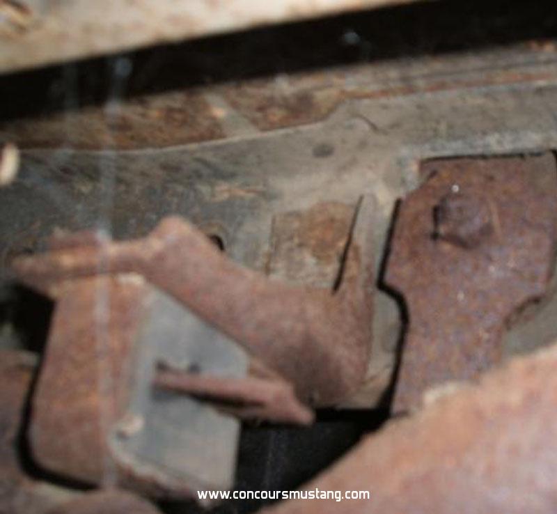

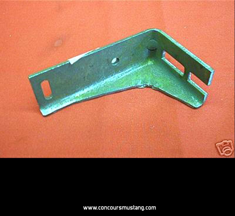

Here's some pictures (first two from an e-bay seller, the third unk) of the "crush plates" for dual exhaust systems in the frame rail cut out of a car, and a drawing of a replacement.

« Reply #12 on: April 30, 2018, 10:27:59 PM »
Ok, I just got home and looked, I should have realized this when I was looking at it last night, but these guys were morons that put this bracket on and tack welded it. They used the wrong hole to mount it, they used the furthest back hole for the one bolt (see photo I circled the one they used), and then tack welded to the bottom of the frame rail. The funny thing is, there is nothing wrong with the real location, holes are there and the crush plates are fine... so stupid. Oh well, this is the type of stuff you find I guess. The other problem is I only have one bolt and nut per side, and they look to be original, so I guess they just chucked the other one needed...
Crazy...
