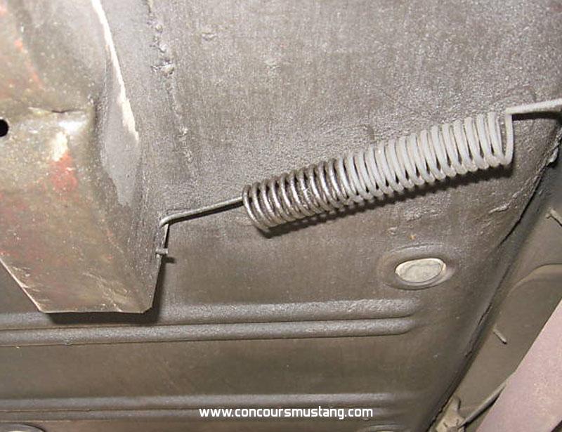

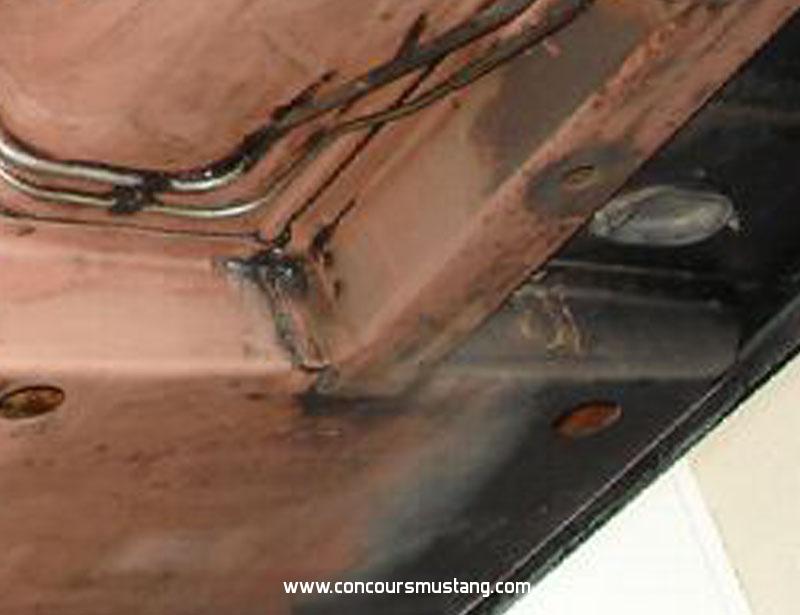

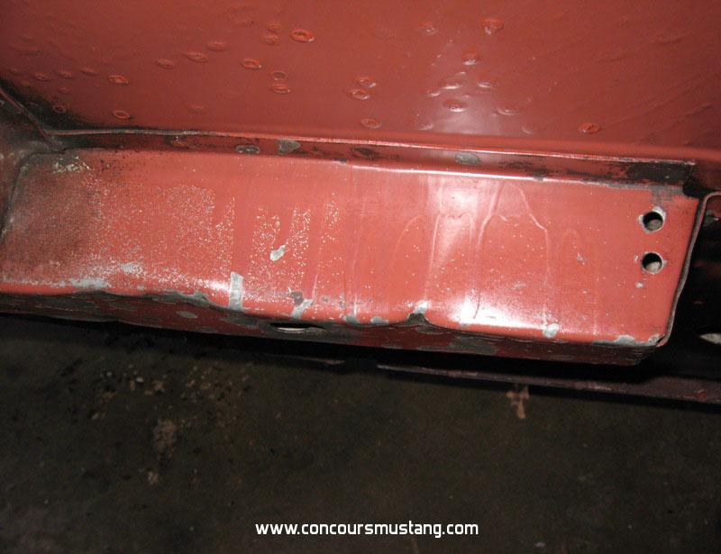

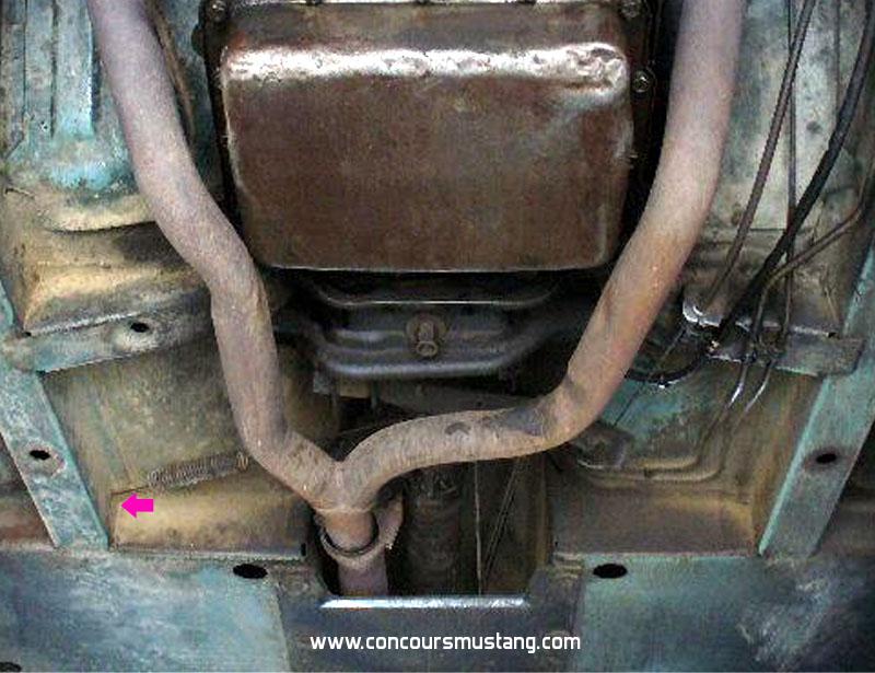

Both front (forward frame rails that start about at the bottom of the firewall and go rearward from there) have the 2 holes in them originally at the rear of each frame rails. And two sets (one inner and one outer) per each frame rail  By designing the frame rails this way Ford didn't have to make drivers and passenger side versions of the frame rails just one version for both.  As you can see fastback and coupes used one version while convertibles another but believe the hole size is the same
These should help you locate the holes
Sorry don't have measurements for the holes handy. But case is a good example showing why you shouldn't throw anything out until the project (and even then) is finished ;) Reproduction panels are often missing brackets, holes and other details that you'll need at some point
