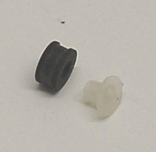

I did some more digging after I posted and found some info that Ed Meyer posted a while back on the Boss 302 forum;
http://www.boss302.com/smf/index.php?topic=74795.0
It sounds like there were two styles of grommet used, and a change in late '69 (early '70 MY).
Manual choke '69 & '70's appear to have used one of the following;
- a 1/2" hole just above the throttle cable, with grommet 379160-S
http://www.mansfieldmustang.com/03-26.JPG
*White sleeve is used for throttle cable on '67 cars (as I understand it).
- a 1" hole just above the wiring harness, with grommet C7OZ-18912-S (5?)
https://www.npdlink.com/store/products/grommet_rubber_repro-169675-100.html
http://dennis-carpenter.com/antenna-lead-wire-grommet/p/C70Z-18912-S/

  • Posts: 7462
Part number 353247-S-A2 is shown in the 1969 Mustang Electrical Assembly Manual (AM0028) page 10 (ref E9-125-3) item 2. I've found no other reference to that part number. For the same application in 1970 (AM0033 pg 13, ref E0-125.3), grommet part number 379160-S was used. It's measurements (from 69 Ford Standard and Utility Parts, AM0205, pg 58) are    1/4ID,1/2OD,5/16T(NO OTHER DIMENSIONS). The service replacement for both 69 and 70 applications is 379009-S (same page as 379160-S).
It is common for Ford Engineering to find a part to use, only to discover that the source cannot supply it for any number of reasons, so a replacement is used. The next model year gets the same treatment, service somehow solves all those quirks with something else. Many times the replacement will "fit", same size mounting hole, same size hole for the choke cable, but the thickness is different. Those are observations, not documented. That's the best information I can find.
  • Posts: 7462
Some additional research has turned up a service "replacement". It's the same grommet used on 64-66 small blocks accelerator pedals to the accelerator arm, part number 379009-S (see NPD https://www.npdlink.com/store/?p=catalog&mode=newsearch&search_str=9A703-1A&parent=1&year=1966 - There are additional items in the "kit".) Will it work? Ford says yes. Can you tell it's a replacement? I won't say a word. If I was going to use this grommet, I would consider using weatherstrip adhesive (like 3M8008) to keep the grommet in place.
Remember, I won't say a word.
