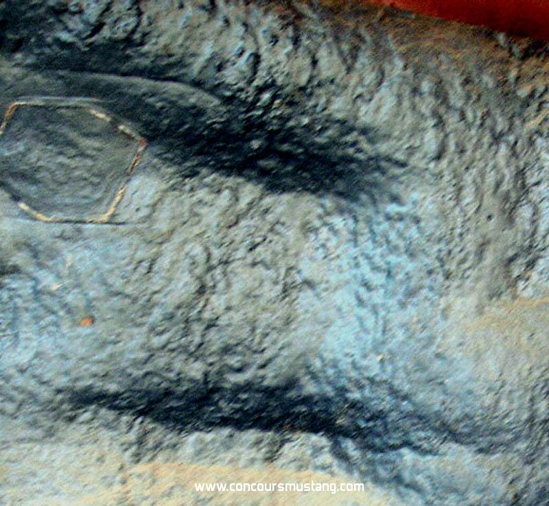

Here is what the texture/surface of a typical San Jose firewall pad looked like
And for others or comparison here is what a typical Dearborn/New Jersey suppliers firewall pad looked like
Neighter are from 67 but they they both show the surface well IMHO

The Dearborn/New Jersey firewall pad looks a lot like this product that I just tested today. In case the picture disappears, it's Rust-oleum Leak Seal:

As mentioned before I found that applying a spray coating (for Dearborn.NJ versions) from 3-4 foot above, raining down from above, produced the best results for me. The messier the spray nozzle got or me hanging the tip of my figure over it seemed to help also
