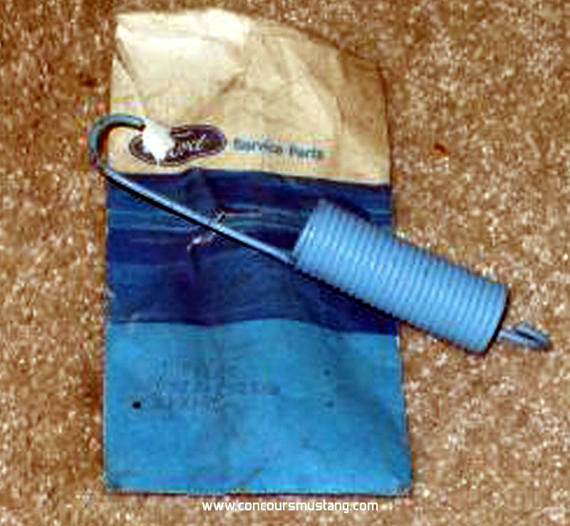

Re: Clutch return spring color
« Reply #24 on: September 11, 2018, 06:00:40 PM »
.............Can you help identify the blue spring?
Let me give it a tray
Have this picture of such a spring (blue spring) in a package marked C9ZZ-7523-B
« Reply #25 on: September 11, 2018, 06:25:42 PM »
Jeff's part number is for a 390, 428, 429 8 cylinder engines for Mustangs, 1969/70 according to the 65-72 MPC (Section 75, page 8.
« Reply #26 on: September 11, 2018, 06:54:32 PM »
Jeff, that can't be the same spring because the thicker pedal type return spring being discussed in the picture from reply 22 has only 13 coils . The coils on the one in your picture number 26 .Although there is little frame of reference the coils look much skinnier and it is a most likely smaller diameter spring from the looks of it in comparison with the bag and the size of the printing on the package.  I believe your picture is for the spring that goes on the upper z bar or lower z bar to the clutch fork.
« Reply #27 on: September 11, 2018, 06:59:04 PM »
................ I believe your picture is for the spring that goes on the upper z bar or lower z bar to the clutch fork.
Checking the part number would tell you ;)  Just posted it as a blue clutch to an effort to help out as I'm catching you after a long weekend trip
Offline CT428CJ
  • Posts: 117
« Reply #28 on: September 11, 2018, 09:56:09 PM »
Thanks but the springs that I posted pictures of are the pedal assist springs from under the dash.
The person that I bought the blue spring from told me that it came out  of a '67 390 Mustang but I don't have proof.
It does work quite well in my 68 1/2.
« Reply #29 on: September 11, 2018, 10:52:25 PM »
I have only seen white springs in 67/68 390 equipped Mustangs. The assemblyline and other factory Ford manuals back my observation up.
