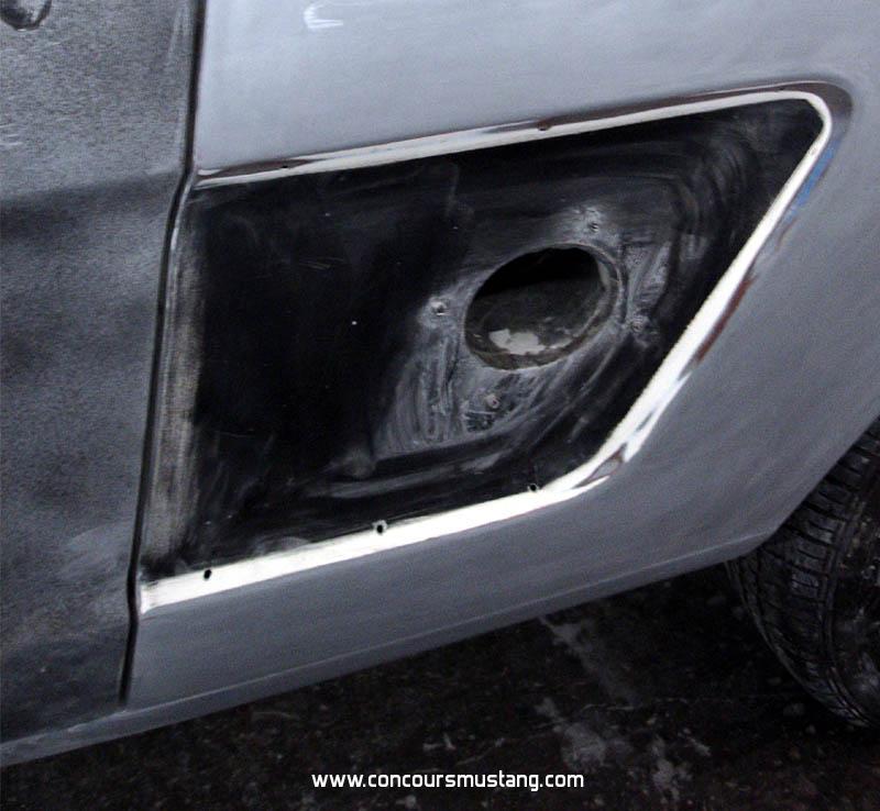

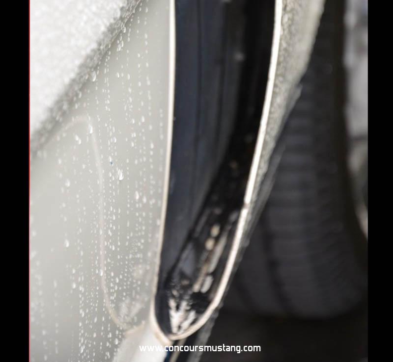

The vast majority I've seen were black on the back side. Sometimes this appears to just be the lack of body color on the back side while on others (more often IMHO ) an attempt for the factory to black them out. Need to be careful looking at examples since it was really common to have owners touch up or reblack out the inside of the scoops at a later date with the scoops attached to the car. The finish on both sets of rivets is the give away/clue.
Some examples - you didn't provide an approx time period or car number so I choose them randomly from through-out the year ;)
Other side of the same car Bob posted a picture of. Carry-over car
Sort of mid production year.
