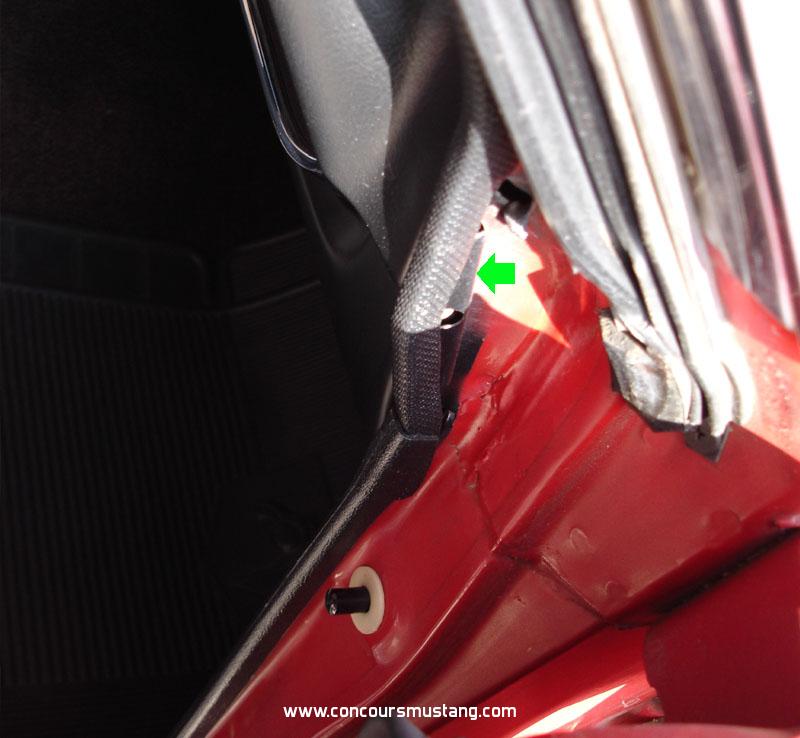

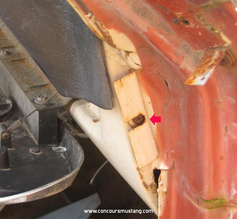

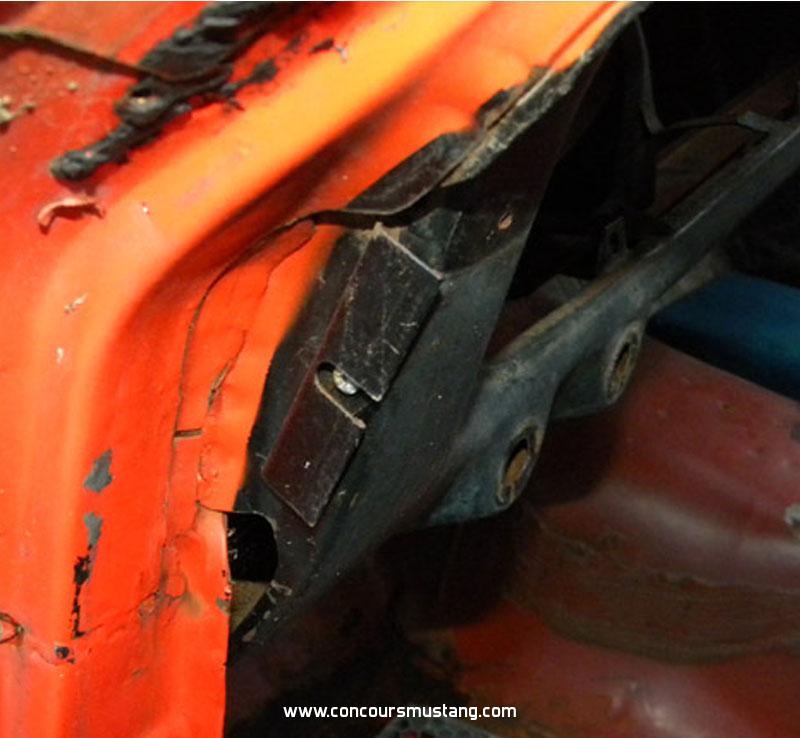

Offline ChrisV289
  • Posts: 1986
Re: Windlace retainer
« Reply #8 on: December 22, 2018, 09:13:59 PM »
So in the last pic tou can clearly see the retainer is painted the color of the dash. I assume they were painted off the car as the screw appears to not have paint on it. Would they have been grouped with the ash tray and speaker grill?

  • Posts: 24919
« Reply #9 on: December 22, 2018, 10:05:27 PM »
Don't know for certain since I've never seen them in any plant pictures, never found a worker who was stationed at such a location or worker describing how these small interior parts were handled. But a small paint line with non-attached parts would be a similar practice as body parts paint application for unattached parts
